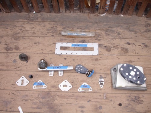

My teak deck replacement (Splash 38/108) deck is nearing completion, so it is time to put back all the deck fittings etc but somone (!) forgot to use the Winter months to get them re-anodised / refurbished.  As time is running short is there anywhere I can buy the fittings as per the attached photo and also deck prism to fit?
I would aslo like to replace rather than service the genoa blocks - can these still be sourced new?

you can get the aluminum fittings in 316 stainless steel instead of re-anodizing them, you can even ask spare parts dept at Nautor new hardware, but suspect they are cheaper custom made by a goog craftmanship. The diesel and water caps should be re-chromed (not anodized).

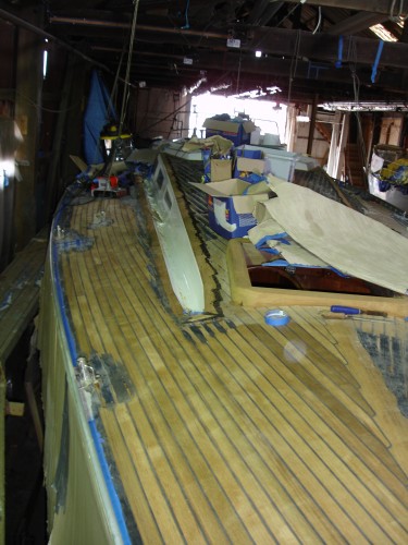

PS: the deck looks pretty good although we have currently got the foredeck hatch frame too high off the deck (see photo) so lowering it - will get there eventually!

Teack deck looks a really well done job! If you want to send me some more and detailed photos, I would love to add them on the MAINTENANCE section of classicswan website.
