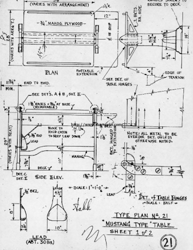

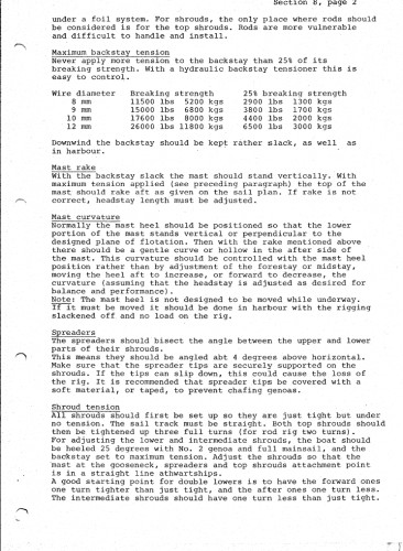

Just bought 411 #41, beautiful boat.  She is missing the saloon table, also cockpit stbd lazarette cover (fiberglass/teak hinged piece).  Any plans for either or other details that would help me make new parts would be greatly appreciated, for example photos of those pieces from all angles, anything short of full plans would help.  Also looking for page 2 of section 8 of the owner's manual, Rig section.

I think the original drawings are now gone, for the table, please see the attached image, this is a "Type Plan" Rod stephens designed for a "Mustang type" table (Mustang was Rod's NY32), hope it is of help.

For the time being I enclose the page you ask. If you want the digitized high resolution version you can either send me your e-mail by private message or I will arrange a passage through Matteo Salamon.

For the table, the drawing published by Matteo are a good start but the actual tables on board the 411 are slightly different: I am sure that someone will be glad to make pictures of theirs.
