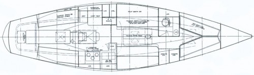

Dear Angus,
is this one enough for you? In case of affirmative answer I can send you a better definition JPG to your personal mail address.

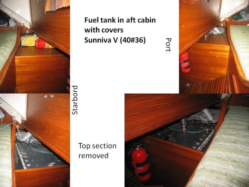

08 September 2009 - 18:45
Posts: 32
Please fgind enclosed some photos from the "fuel tank hood" in the aft cabin in my Swan 40 (Sunniva V, 40#36) with the top section on and removed seen from starbord and port. This is the original setup.
Hope this can be of help for you.
Best regards  Leif
