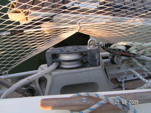

I realize that the genoa blocks on a 41 were alredy treated here but this is the turn of a 411 where they are slightly different and I need help.
I succeeded in unscrewing the four 19mm nuts and the central 24mm nut placed in the under side but I am not able to go further. The bolts are stuck and the black body of the block assembly would not move. I wonder if the lower grey aluminum plate is also threaded and the bolts are screwed in it.

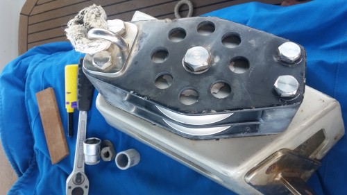

hello, i am at the same job now and corious to know, if and how you got the job done.
i tried the impact driver but no heat for now.
is there a plastik bearing or something that can melt?
i dont want destroy more than necessary.
for me it is only the top sleve of one block, this one is not spinning well.
may i can get rid of it by scraping it out and put two half moon sleves back!
fair winds, stefan

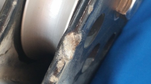

17 November 2018 - 20:42
Join Date: 07 October 2014
Posts: 74
hi philippe, writing again, because wasn't logged in and all lost. think that happens to somebody of us - for me it is not the first time.
thanks for your reply, helped me realy, was close by to heat the center bolt.
i could disasemble all nuts but not the black block. with strong force i am having here.
but by that i figured out, what was the reason for not spinning well. the block got a strong impact by something and got deformed. that was stopping the wheel - stupid that i did not saw that.
i could fix this and "voila" it spins well again.
for now it is fine - i need to go forward to go sailing one day.
the block will need some more love to be perfect again. may i try a machine shop here in grenada.
thanks for opening my eyes on that - and i will remember "NO HEAT"
