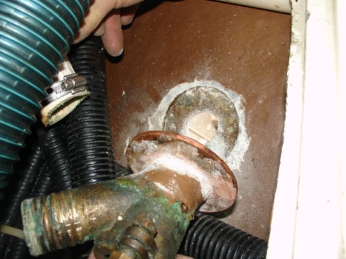

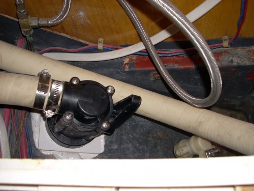

Dear Richard, I replaced all my seacocks on Fandango. I initially had the Blakes replacements (pricey), but when I took the old ones out and I noticed how bad they were from electrolisys, I changed my mind and instead of the Blakes I installed the ones from Forespar made out of marelon. Check them out, they are very reliable, in fact, according to Forespar, they are now standard on the new Swans (Did not check on this). They can also be recessed into the hull and some have the capability of taking two hoses at a low profile, in case you don't want to open any more holes on you boat and you want to add a water maker.
To give you an idea on how bad the old ones were, when I pried the one from the galley sink, it easily broke and it was all pink inside (corrosion indicator).

It appears Forespar is not well informed, the smaller performance Swans use their Flowtech model because of its flush-closing properties. This is not the same model as shown in the picture above. The bigger Swans use bronze seacocks.

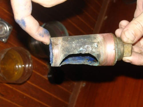

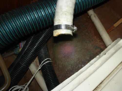

I think that the blake seacock are made of brass covered with bronze (or is it copper?)  Once there are warned out the brass is in contact with see water and the corrosion comes in.  I have maintained mines (swan 47 n°59) (see picture) and we can see that there is still bronze on the top but there is no more where the hole is.  Not all of the 7 seacocks are like that and some are perfectly clean and beautifull.  I will therefore try to buy new one but without changing the part fixed on the hull.  Do you think I can still find these spare parts?  When do you think you must change the whole seacock?

In your picture it looks like the cone has deformed so the middle part is concave, and does not touch the body when inside it. If this is so it could be tried to expand the middle part so the cone becomes straight.
If there is too little thickness left, or the body has expanded through corrosion in the middle part this will not work.
Daniel

There is a part of the cone that is in contact with the water inside the boat when closed. I believe this is why we have corrosion there.  My plan is to change the cone and to grind the tube with the new cone.  I have asked for this cone only but have not had any response from the distributor yet.
Is this a bad idea?

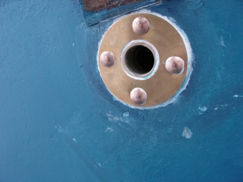

Thank you for all your advices.  We changed one seacock by original blake seacock.  I was surprised to see that the orginal fitting was just with polyester and not with bolts.  After some discussion we decided, for the new seacock, to use the bolts that are proposed by Blake.  This changes the outside apearence and was quite a lot of work as we repaired the polyester first.
For the next replacement we have not decided yet how to fit it: with bolt or with polyester?
Any advice?
Ludovic

We did put first fiberglass to fill the gap left by the ring of the old seacock and then did a hole again so that the thickness of the hull was leveled.  We also then covered with gelcoat (see pictures)
I also ordered the special the seacock grease from Blake (a green stuff).  The previous owner of our boat had showed me the maintenance with simple marine grease.  The difference between the blake product and a simple grease is incredible.  (En français: il y a pas photo!)
Another issue is that the new seacock have a grease valve enabling to add grease while in the water.  This is a major improvement but I do not have (yet) any idea of the normal grease injection rythm (once a month?)
