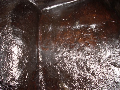

Hi Jason, I cleaned my tank on 07, it was not that difficult but my boat does not have the woodwork above the tank. I got a 30 gal drum and with a dc Jabsco pump rated for fuel I emptied the tank passing all the fuel through a 500series Racor fuel filter with a 2 micron element. Once empty the tank was cleaned with mineral spirits (2 gallons) and lots and lots of rags. Then I checked all the fittings and replaced hoses (fuel rated) plus added an online fuel valve for convenience. The next step was on the other end, I added a 3-way  valve, one  end was the supply, another end went to the primary fuel filter (Racor 500 with 10 micron element) and the other end went to an in line motorcycle fuel filter then to a  priming pump and from there to the same filter via a t-fitting. The ideal situation was to have the priming pump after the primary filter but I did not have the room. The inline bike filter allows me to see through and visually detect dirt and it also protects the priming pump.
After all the plumbing was done, I put the fuel back on the tank filtering it again. I transfer 5 gallons of fuel at the time and with a teak dip stick (1cm X 1cm X 100cm) inserted through the fuel fill I marked the height of the fuel fill plate on deck and put a notch at the height of every 5 gallons. That is my most accurate fuel gauge. I know it is archaic but it works for me. By the way Jason, as far as I can tell, you can not remove the tank, it is integral into the hull. I also kept the DC transfer pump with the Racor filter and I polish my fuel periodically. In addition to that I use a fuel additive and keep the tank full to prevent condensation.
Regards, Rod
The attached picture shows the inside of the tank.
