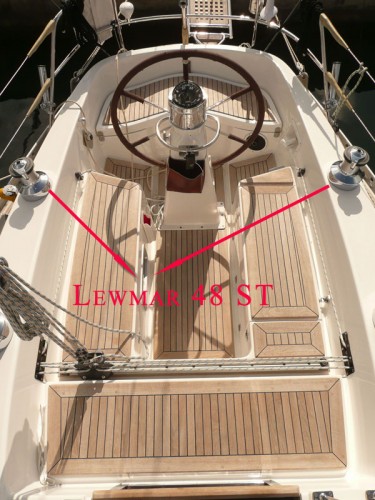

onboard 38/067 Only You I have two Lewmar 48 ST, they perfectly fit on the old ones place

I have measured the diameter of the present winches and it seems that the lewmar 46 st is about the same diameter ?
Therefore (and because of the price diefference) I would like to go for the 46st; I mean the old ones are lewmar 44 and they served well (not too small) ?
Or do you have other experience or reasons to go for the 48 st ?

should ask a hardware specialist, which unfortunately I'm not, anyway I don't think there's much difference between 46 and 48 (anyway with 48's you've got enough power for the spinnaker guy)
