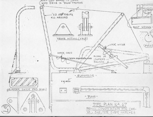

Dear Geoff,
attached is one of the famous Rod Stephens Type Plan, which he was so generous to give to who asked, hope you can get some advise from this design
Fair Winds!
21 February 2010 - 15:20
Geoff, Tip, I have put a window onto the top of the hood as well. It lets a lot more light down into the cabin.
John B
