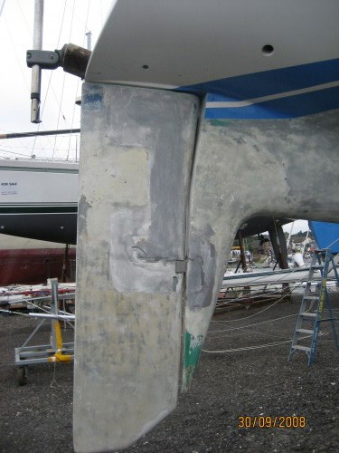

Guys, please find attached picture.
Mine is hull no 010 . It would be good to know when the extension was made in terms of hull no, if it was a Swan modification.
Also to so to see some other modifications if not made by Swan.
I get some cracking around the mid section pintal, not sure if this is due to the loading or that the bolts just need to be tightened on the straps.

The Swan 411 rudders were made deeper after receiving feedback from racing owners reporting broaching. The hull number from which this happened may be on record at the yard provided somebody can find this old information.
The cracking at half height in the picture indicates that there is too much flexing in the blade at this point. If reinforcement becomes necessary this has to be put outside the straps.

06 March 2010 - 09:38
Dear John
The recommendation is to reinforce the blade skins locally in the vertical direction.
This can be done by adding patches of GRP over the straps each side, bridging the recess.
The patches needs to have tapered ends, and can be either glued or laid up in place. They should be straigth continuations of the skin laminate
If you can inform which glass reinforcements are available, and the thickness that fits into the strap recess this enables a layup proposal to be made.
The thickness, length, and width of the blade below the crack is also important information.
Epoxy resin recommended.

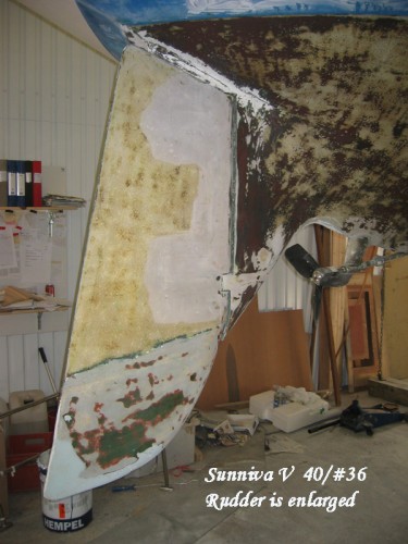

Just for information it seems as I have an enlarged rudder also on my Swan 40 as shown in the attached photo. According to my experience from offshore racing her with spinnaker today, this was obviously needed to avoid broaching during spinnaker sailing. I am however not sure whether this was changed from the beginning by Nautor or after some racing experience by the former owner.
Leif
(Sunniva V, Swan 40#36)
