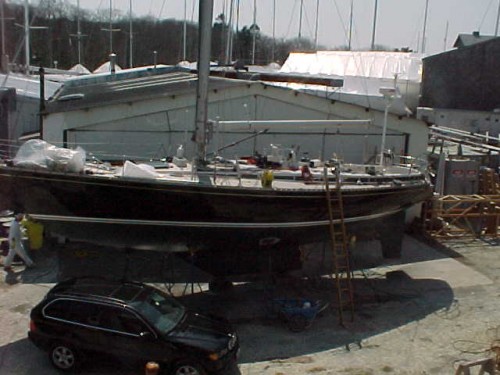

I have had a dark red S&S Swan, two white ones with blue cove and waterlines and now a black one. The white ones were easier to keep looking clean but I like the combination of a black hull and a green awlgrip antifouled bottom which is quite a common combination on the US East Coast.
For me the Nautor trademark is the double waterline which they used from about 1973. We have sailed Black Tie in warmer waters and she has shown no degredation due to the hull getting warmer.
I think the answer is to choose what you like - I can remember that the US Swan owners were much more inclined to have their boats awlgripped in strong colours from new. Gavin

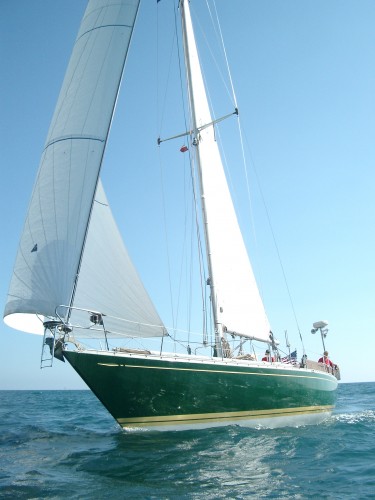

Hi Christophe, I have a Portofino Green hull/gold trim that is 8yrs. old, works in the Southern Italian + Tunisian waters in summer where it gets pretty toasty. Have NO problem with blisters, or heat on board, and apart from being able to see all the "gifts" from others as they leave their moorings or other mishaps, have found it a really wonderful combination especially at anchor against a Mediterranena sea...As for the original choice, it's wonderful, but color is not an issue to most S&S owners or buyers I don't believe. It's personal and doesn't compromize the integrity of the yacht. And as for the salt spray that's visible, well...have to say I don't mind at all! Sort of like seeing an offroad vehicle with mud...means you've actually been sailing! whatever you decide will be terrific. Cheers. Jayne 47/047 Aorangi PS don't know how much the quality of the paint has to do with it, but am very pleased with the Boero Challenger Bi-Component that was used.
