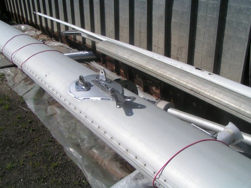

Hi Geoff,
sorry I forgot about the runners. Yes I do have them and presently they are as in the original plan. The connection at the mast is included in two ss plates under the spreaders where the lower diagonal (D1) shrouds are attached. The runners are attached via a fork with a pin. I am pretty sure that you will find the same plates also on your mast.
My runners are tensioned by a 4-way tackle (hardly sufficient).
I am going to use a synthetic for the staysail stay but I am not as sure about the runners.
