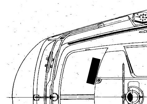

ciao Daniel, the position I'm thinking about is inside the lazarette under the helm seat on the starboard side bolted to the fore wall (as in the drawing). This is a ventilated area, far from the cabin. I'm thinking of putting the socket inside here also and cutting a small groove for the wire in the hull under the hatch. Off shore this can be plugged. The inside socket prevents a big hole in the cockpit wall. a presto Pippo, 411/22

ok, I understand. The only problem I foresee is that that part may be rather damp - this is especially true in my boat where that locker is frequently used (I keep there the aft mooring lines, the water hose, the electrical cable and other useful stuff in port). I would be careful in positioning the charger in a relatively protected dry place because those devices are not usually built to withstand water spraying... unless they are indeed!
Daniel, 411-004

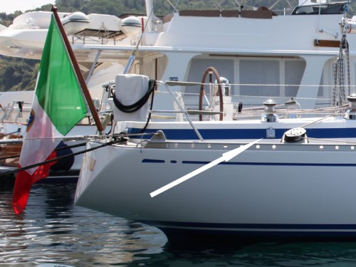

I used to have the socket where Pippo wants his, but it was not so comfortably (but the 38 is smaller than the 411), and when I re-painted the hull I had it placed outside the cockpit. You need a very good quality socket (I decided for a Marinco, completely watertight).

My set up is just like Daniel's - I can say that my Hart system is very quiet - no noise trouble really at all that I noted. As for filling the cockpit, that shouldn't matter with a good fixture. I like Matteo's location, because with it, you don't have a few feet of cable hanging over the coaming to trip on, or lose length with, etc, but it does break an otherwise clean exterior surface. All in all, I think the other comments regarding putting your rectifier/inverter system in the aft space are valid, namely: this space is too wet. I would be interested to know if anybody talking about noisy systems has the Hart?

On our 40 the external plug is in the same position Matteo has described. It is a good solution as it keeps the cockpit clear of cables. As for the location of charger and our inverter, I have installed them in the cupboard underneath the chart table. Took a lot of time!!! Not much space but it is a nice dry place for the electronics. To me this is the primary consideration as water and electronics don't mix.
