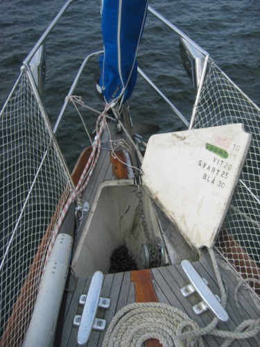

As I want to place the second forestay as close as possible to the original one in order to keep the  selftacking jib on the second furler as large as possible, I would appreciate to get to know what the distance is between the forestays on your boat (both on deck and on the mast). From your picture as well as the drawings and figures by Guegan Yvon from “Kallinira” it seems that they are much closer than what Matteo talks about on his Swan 38 “Only You” (about 170 cm between the deck fittings). For me it would be an advantage to have it just in front of my hatch to the anchor chain box (see enclosed picture). The distance would then be 55 cm between the centres of the  forestay fittings.
Any comments or advice?
Leif

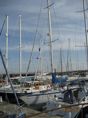

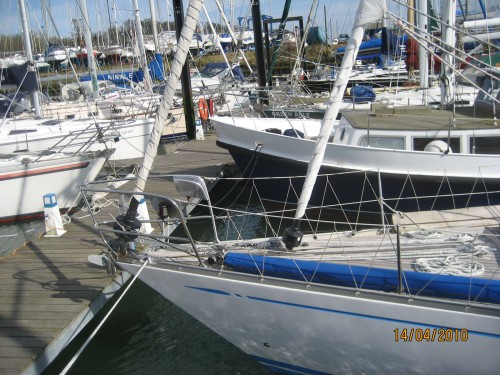

05 May 2010 - 23:03
Leif, some photos of what I have done. It has been very good so far in terms of dealing with heavy weather when short handed.
I used the exsisting babystay and track so only need to buy a light furling system.
John

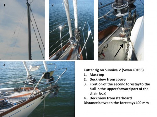

15 January 2011 - 11:53
Posts: 32
Thank you all for the comments and suggestions about how to solve the modification to a cutter rig on my Swan 40. I enclose here some photos showing my solution. Sailing in the Baltic and the archipelagoes in Scandinavia I was keen on keeping the possibility to have as large as possible area of my self-tacking jib. The question was then how close could I place the second forestay behind the first one. My solution was 400 mm. It is close, but it functions. It is even possible to tack with the roller genua (53.5 sqm) on the first forestay, better than expected.  However it has also meant that I could use the #2 genua jib on the second forestay in case I wanted it as an alternative to the selftacking jib without the need to roll in and out when tacking . And the size of the new self-tacking jib could still be 25 sqm.
