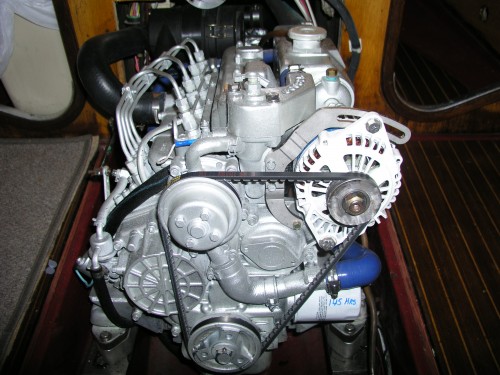

i replaced my Perkins 4-108 with a Beta 50 HP 2 years ago (I kept the original Borg-Warner transmission - which I had rebuilt). The price was about the same as a Yanmar, but my mechanic recommended the Beta so highly I went with it. It is quieter than the Perkins ( though the 1/2" of sound insulation I added certainly helps!). I can't speak to replacement parts in the the Med or Atlantic - I'm on US pacific coast, and was assured parts in Central & South America and So Pacific are readily available.
I have been happy with the engine and the installation was pretty painless....
