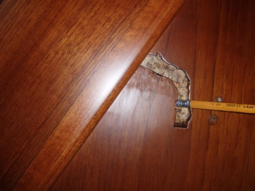

Hi Guys:
May I add a request for tips on how to repair some damaged teak left over from a previous owner. I believe they tried to hide a wire in the groove. Now it is exposed and unsightly.
I look forward to your ideas.
Milo
