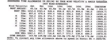

Enclosed pls find target speeds for Swan 38 tall rig

Does the target speed table for Swan 38 extra tall rig differ significantly from the tall rig table?
Regards, Jyrki
22 August 2010 - 10:30
Jyrki

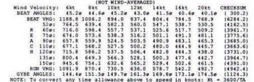

Enclosed the same table for the standard rig.
The extra tall rig can be expected do show roughly the same differences compared to the tall rig, as the tall rig shows compared to the standard rig.
Should I work out a new table for you?
