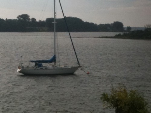

Storm Svale.
And a picture of Storm Svale resting

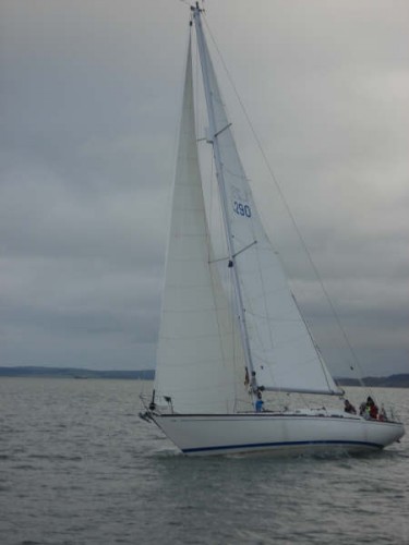

Hi Mike, I have Can-Can IV (40/29) which also has a tall rig and are now about 95% through a restoration. We have basically replaced everything above the deck inculding sails which we purchased from Sander Sails here in Lymington in the UK about 2 years ago and have been very pleased with them.  We bought Performance cruising sails made with Hood Vektron which is lighter and stronger than Dacron, with a fully batterned main using a Tidesmarine Strong track originaly to fit the original mast and a furling Genoa using Harken gear. The mast was also replaced and was made by Selden. The spec as follows:-
1)  SAIL:  MAINSAIL
a)  Hood 7.7oz Vektron
b)  Slide luff
c)  Sail number
d)  Fibreglass battens
e)  Tell tales
f)   Sailbag
g)   3 Rows of slab reefs
h) Loose Foot
I)  Fully battened option using a ‘strong’ system including 5 battens cars, 6 intermediate and a headboard slide
3)  SAIL:  ROLLER REEFING GENOA
b)  Luff tape to suit reefing system
c)  Foot markers
d)  Tell tales
e)  Sail bag
f)  Sunstrip
g)  Foam luff padding

Hi Jason,
She looks nice.!!! I like the looks of the rig!! The guy in the US is talking about the top 3 battens being full length. Did you discuss this with your sailmaker? Did he mention headsail battens? I saw this on some racers here this past weekend. Anyway, the Dacron cloth the guy in the US is talking about is heavy but is tight weave and low stretch which should mean it holds its shape longer. I will give your sailmaker a call and see what he comes up with. The dollar is low and the guy in the US because he does not advertise... all word of mouth has come up with a great price. Transport is the issue!

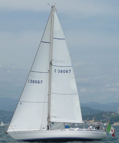

Dear Mike,
North Sails Europe (HQ in Denmark) has offices and lofts in many European countries, and as far as I know, if you are based in EU you can buy sails where you prefere (in Europe), anyway the guy I am talking about is not a North Sails employe, he's "just" a sail designer (and a very very good one), you can ask his professional task then you can buy sails wherever you prefer, even from other sailmakers. He's been working with North Sails for many years so it's easier for him if your choice is NS. He's been designing sails for two America's Cup campaigns (Italian).
Anyway, here you are, attached is the (his words) explanation you asked for:
Mainsail Cloth choice.
To build a good performance Dacron Mainsail, the key is to use the correct material for any Yacht rig proportions. The goal is always to achieve enough lower-Leech tension to control the upper Leech twist, in order to tune the side forces according to the wind strenght, but keeping enough forward driving force, good for speed.
A Low-aspect rig has a relatively long Boom. The sheet tension required to control the upper Leech twist is minor. The principal load path, starting from the Clew corner is travelling more inside the sail aiming to a point at about 3/4 of the Luff, to turn vertical towards the Head.
A shorter Boom, Higher Aspect sail has the principal loads running much closer to the Leech. In addition, the Sheet tension required to colse correctly the Leech is much greater. This is adding alot of strain to the lower Leech in particular.
There are families of Laminated sail cloth, where the inherent fiber modulus can guarantee a very small elongation. Being oriented along the cloth length (Warp), these are suitable for Radial panel layout construction. Kevlar, Dyneema or Carbon fibre are used in different cases. Polyester warp oriented woven cloth can not achieve enough strenght, as required for an High Aspect mainsail.
Different kind of Dacron woven cloth are available for traditional Cross Cut layout. Apart from being quite alot cheaper, they feature a bigger Fill yarn (across the roll) that can delivery the required strenght. If the sail is assembled with strong enough seams between all the Cross Cut panels, the result is a stronger Leech sail, compared with a Radial cut Polyester Mainsail.
Typically, a High Aspect Mainsail is associated with a very Low Aspect Genoa, because most IOR sailplans have quite a long Fore Traingle base "J". In this case all genoas can be built Triradial, using either Polyester woven or laminated, also depending by the "taste" of the Yacht.
28 August 2010 - 07:45
Hi Matteo
NIce picture. These are beautiful boats!!! Anyway, I am learning a lot about sails. Wish your designer was here!!
The plan is for a C cut main with high density Dacron and a tri-radial 125% laminate CAL with the new batten material. This should allow more roach in the Genoa thus helping the trimming of the upper part of the leech among other things.

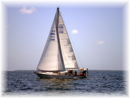

Hi Mike, for what is worth, let me tell you what I replaced my original sails with. My new main is made out of 9.8oz dacron with 2 full battens on the top and 2 3/4 battens at the bottom. Three reefing points with nylon webbing handles above each reefing point to aid pulling the sail down, also loose footed and a draft stripe. I accepted the sail maker's recommendation to go with the 9.8oz, since the sail was designed for true blue water crossing. The genoa is a 140 with luff tape and 2 reefing points with markers. Sumbrela Sun protection and tell tales. For my sails I was in contact Peter Grimm from Super Sailmakers, 4710 NW 15th Ave Fort Lauderdale, FL 33309, Phone(954) 763-6621, a very active and knowledgeable racer and sail maker. Now,I have not done much blue water sailing lately, and the cloth weight on the main is a handful, I suppose it will shine in the middle of the ocean when things turn for the worse.

More bits and pieces about my sails, the genoa is made out oz 8oz dacron, there is foam at the luff for the reefing. I intentionally asked for it not to be a deck sweeper since I wanted it to be raised from the deck so it could allow the water from a breaking wave to be spilled from the deck as soon as possible. This is from previous experiences during blue water sailing, where a wave would brake against the forward windward quarter and my old deck sweeping genoa would keep all this water on deck until it was slowly drained aft.

Thanks Rodrigo,
She looks NICE!!!! anyway thanks for the info. The main will be 8.8 oz Dacron with two full battens and 2 3/4 battens like yours! Just a lighter cloth. As for the Genoa.. I lost a number 2 deck sweeper a few years back. Took a wave into the bottom of the sail. Bang... Learning from that lesson I have and will avoid deck sweeping genoas. I will let you know how the CAL battened genoa works out. I have not received any comments on this approach but have decided to give it a try...
