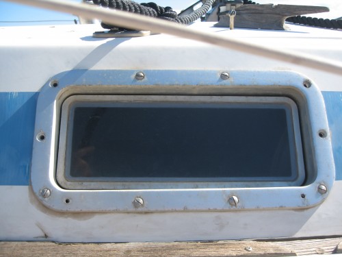

hI all, the port portligth of my S&S SWAN 411/39, who recently acquired to rehabilitate was stolen (as almost the starboard one (see photo attached)).
Can anyone tell me where I can purchase it?. Unfortunately I have not had any response from Swan spares.

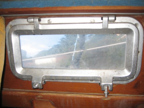

In my case the cockpit portlights are exactly the same Goiot of the side ones and they can be opened inward also. There is a small difference that, wisely enough, was devised by Nautors, I think.
It consists of an additional frame flange screwed on the outer side of the side portlights that fixes better the perspex panes.
Indeed the perspex is only glued to the original Goiot frame and, with sufficient pressure, can be pushed outward. The additional frame prevents this possibility only on the side and more vulnerable portlights.
There is another thing I would like to add: as written, the original cockpit portlights open inward. Due to the inclination of the surface it often happens that fresh water (or worse) spilled by careless crew enters quite easily the cabin. Maybe a better accomodation could be devised...

The amount of water coming in when opening an inclined porthole can be reduced by taking care that the frame drain holes, visible at the lower corners in the picture above, are open. In some cases it may be necessary to change the angle of the drains.
If the glass is recessed into the frame an added wedge of Perspex or mastic at the lower edge would also prevent water from standing there.
