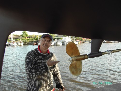

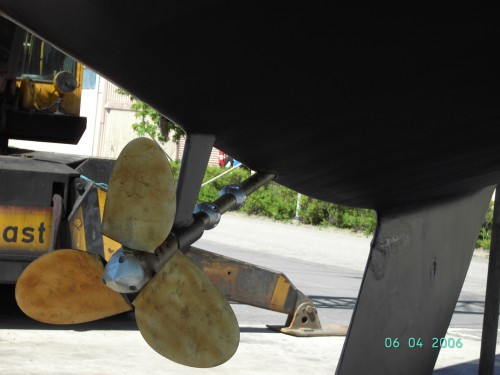

Hello Jayne,
Is it possible at all to mount the blades with edge facing forward? I doubt it. Perhaps lars can illuminate the issue?
pic enclosed
Cheers/Philippe
(47/050 Farouche)
