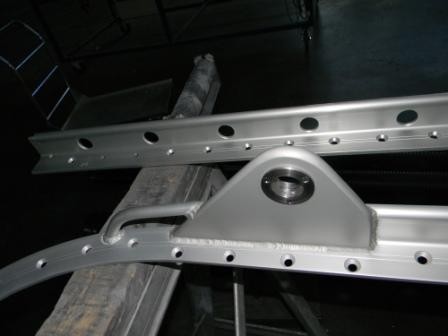

Hi all -
Somehow my text got lost when I posted the pictures - Nautors has accepted our order of new toe rails - they sent back photos of the rail (not sure if these are old pics, or they actually had a set done in stock), and a nice worksheet detailing the job of replacement.
Just thought those of you who wanted to do this job might want to know, and as Lars pointed out earlier, this rail goes on a lot of boats, so maybe strike now while the iron is hot, who knows how long Nautors will do this?  They seemed to stop once already, next time might be for good.
