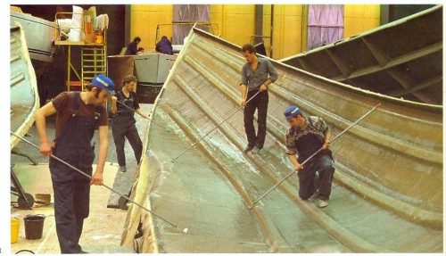

It is correct that the hulls are made of two halves. The older Swans have tumblehome in their topsides, and this requires that the moulds are split in order to get the hull out. When doing the lamination work it is much preferable to open the mould halves, and work downwards with good ventilation. See picture below. When the halves are finished they are joined along the centerline with a laminate which is slightly thicker than the adjacent areas
It is difficult to say what would cause the cracking, maybe hot sun, but I would suggest it is cosmetic. You should, however keep an eye on the crack. It could be tried to pry it open, and fill, fair, and paint, and see if it comes back.
The deck is in one piece, and glued and bolted along the edges to a flange on the hull. The flange is visible in the picture.
