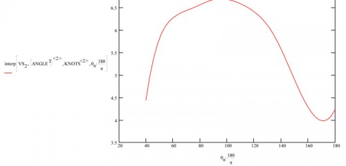

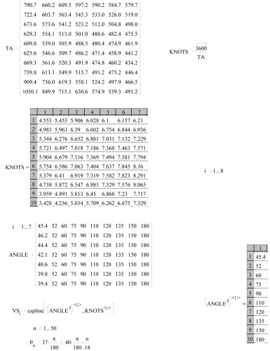

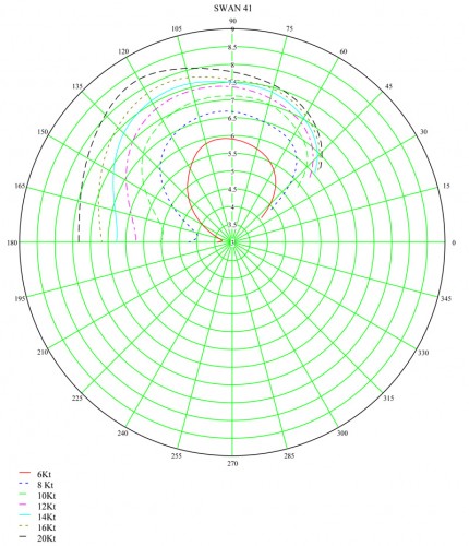

I have written a MathCad spreadsheet that plots a polar graph for the Swan 41 from data provided by Lars in an earlier post.

This looks great would you share the original sheet? So others can use and input data for their own boats. I have a 44.

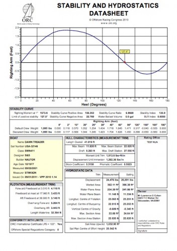

An official ORC Stability Certificate for a 411 is provided below; the AVS is 128 degrees. The certificate also provides much of the information required for developing a Polar chart.

Also available from ORC is a Speed Guide for yachts having rating certificates,
pls see http://data.orc.org/public/samples/Speed_Guide_Sample.pdf
This is a developed version of the polars/tables so far presented here
