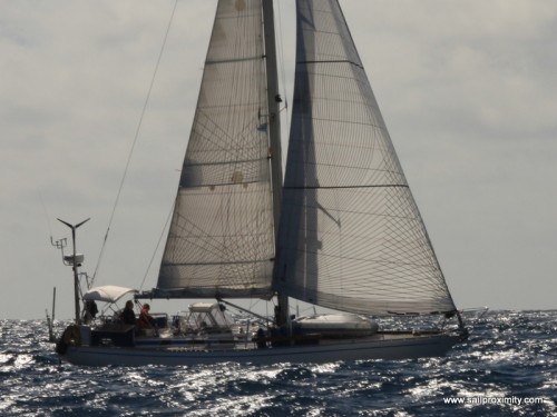

Here on Proximity, we are using a set of UK Halsey Passage Maker II laminates. They are mylar, spectra, carbon tape cruising sails. We have had them about four years on San Francisco Bay, then in September, 2009, we went cruising with them. We did Mexico then across the Pacific, and we are now in New Zealand. We had the sails inspected by the local Doyle loft. They are still in fine shape with many seasons ahead of them. Will they last as long as dacron? I doubt it, but they have already lasted as long as dacron would have kept their shape. They are also much lighter than our old dacrons, so there is less weight aloft. So, there you have the two schools of thought. The dacrons will last maybe 20 years, but loose their shape, and are heavy. A good laminate will have near perfect shape until its life is over, and I guess that is the unknown, but I'm sure it will not be 20 years. Bottom line is that we too, are happy, and would make the same decision again. Either way, you'll be happy. New sails are wonderful!! By the way, if you would like to see more of these sails, we have a website of our travels with many photos. It is www.sailproximity.com Best Always, Rod and Elisabeth
