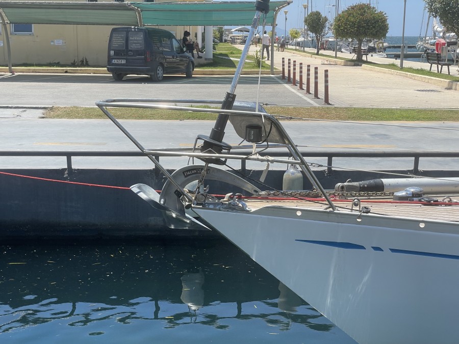

I switched from the original CQR 20kg to a Rocna Vulcan 25kg this year. Before doing this I checked with a cardboard template if any modification to the bow setup is needed, and it did not look like that.
We have been quite happy with the CQR in France and Italy, but had issues in the Ionian islands in Greece, which caused me to check for an alternative. I spent quite a bit of time viewing the Youtube SV Panope videos, where btw CQR gets consistently bad ratings compared to more modern anchors. The Vulcan Rocna performs well in the tests and looked like it will fit. A more expensive alternative would have been the Ultra.
As expected the Rocna did not require any modification of the bow. Unlike the CQR it autolaunches, and it does not touch the furler drum when going down or being lifted. It is therefore possible to safely launch it with the remote control from the cockpit.
The experience so far is good and this anchor is a considerable improvement compared to the previous one. It is however not a magic anchor that holds when dropped onto whatever ground - due diligence is still required, as expected.
