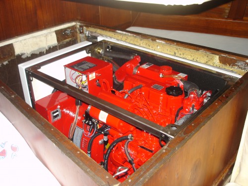

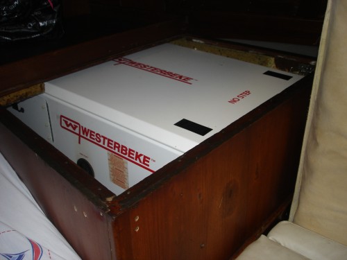

I have a 8Kva Westerbeke installed between the berths in the stern / main cabin (in insulated case with specific blower and exhaust CO2 detector within the outside wooden compartment), running flawlessly under heavy duty demand, i.e. long periods (frequently up to 30 days daily use) and conditions (high latitudes and heavy seas during long traverses like Papeete - Ushuaia or Punta del Este - Ushuaia). Apart from frequent inspection and preventive maintainance, the only replacement, besides the raw water impeller, was the raw water impeller axis kit (every 3.000 hs).

Thanks for the pictures, it looks great! How tall is the compartment in which the generator is installed? Is that a 110v or 220v unit?
