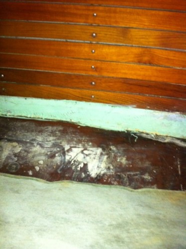

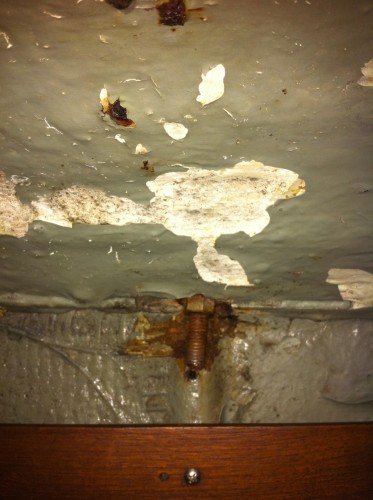

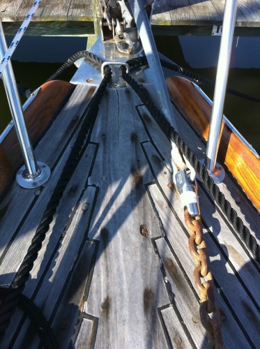

Dear Chris
It appears that the deck leaks under the fittings, and this is likely to be caused by improperly done caulking of the bolt holes. Also the screw holes drilled when installing the teak deck can leak. An original teak deck would not have survived 40 years, and the reported thickness also suggests that it is a later installation.
It is suggested that you check if the teak deck is properly attached to the substrate, this is done by walking on it while it is wet. Water squeezing out from the seams indicates it is loose, and needs to be rebedded.
I would be interested to hear whether the deck indeed is single skin, early hull numbers can have this instead of sandwich.
The leaking bolt and screw holes need to be filled with mastic. For the bolts the recommendation is to chamfer the bolt hole upper edges, so a bead of mastic is formed at deck level. To prevent the mastic under the fittings from being squeezed out completely when the bolts are tightened is suggested that small spacers are put in below the fittings, they could be made of cured mastic.

Hi Lars,
Thank you for your informative reply. I do not know the Hull number (and will find this out) but I did notice what appears to be glassed in stringers running along the underside of the deck. I observed this in one location, did not thoroughly inspect to see that this was consistent throughout boat, on the starboard side near the chainplates.
Do you know exactly when Nautor switched to a cored deck? This is a 1969 boat, according to owner. Or which hull number. I am much more concerned with a cored deck and the water intrusion that with a solid glass deck. The current owner says that all leaks come from deck fittings - this may be true. It's curious though that he has made significant investment two years ago into systems and allowed a minor maintenance problem; i.e., re-bedding the deck fittings, to ruin the cushions and cause a mold problem. In contrast to this, the current owner appears to be an upstanding guy - I am a pretty good judge of character and he seems like a great guy who is honest.
Since I don'd have my original note, I cannot remember if I mentioned the level of work necessary to repair the deck. I have attached three pics to help better describe what I am trying to evaluate.
