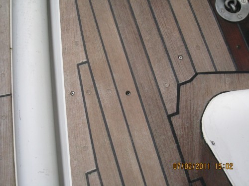

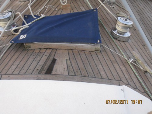

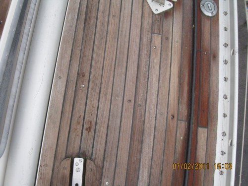

Here are some photos of the deck

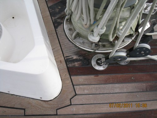

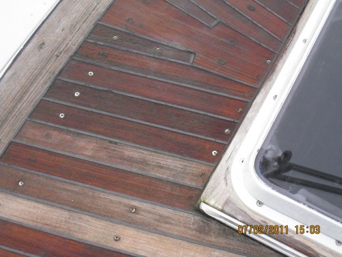

Here are 3 more photos of the deck

Dear Tom,
The area around the mast is plywood, so there is nothing you can do if not changing it.
The dowels are popping out as The wood is consumed, you should get out the screw, very carefully get a deeper hole without going too deep... and re install the screw and a new dowel on top of it. Not a difficult task but time consuming.
About the caulking you should cut away the part which is above the wood level, with a very very sharp knife. Do not sand the deck if you have not cutted the surplus caulking before.
Restoring a teak deck is not difficult, but you should have a lot of time and patience...!
