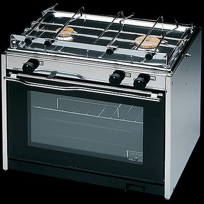

Speaking of the stove try the Techimpex (http://www.techimpex.net/2k9/), a quite good product, stainless steel, good price

concerning the stove, I have to tell you my Techimpex has two burners too, but even if I complained when I bought it, I must say I am now very happy. It is unlikely you to use three flames in one time, and as the cooking area is quite tiny it is better to have two instead of three. Even with Italian coffe machine (Bialetti) which I like so much, the small burner is just perfect!

Re: Techimpex cookers. I've recently purchased a 36 (021) and she came equipped with the TL2 model. I agree completely with Matteo. These are excellent great value stainless steel cookers with robust pan clamps well suited for cooking offshore. Their ovens are particularly good - they heat to the desired temperature quickly and the TL2 model comes equipped with a very useful temperature gauge. Many cookers don't include this feature. And they bake bread beautifully!
The TL2 Dimensions (W x D x H): in mm
500 x 435 x 465
Width Including Gimbals: mm
526
I hope this is helpful.
