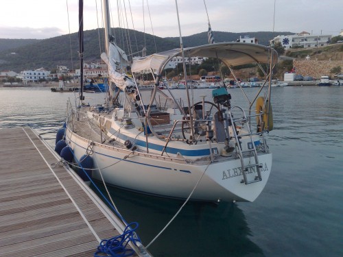

Good afternoon gents,
Attached is a picture of Alexandra, with a bimini I made a few years back. I use the top of the bimini for my 4 flexible solar panels, which provide power for my fridge and water maker.
Hope this helps

Thanks for your answer, can you send me some more photos?
what appens when you close it?
