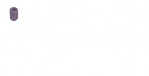

Also can you help in explaining how to remove the top flat plate covering the binnacle,we have removed stainless compass housing, we have also drilled out rivets round the side, is it a question of just tapping the top off? we are a little nervous as we have had our binnacle profesional resprayed. hope you can help.

The pedestal cover plate is attached with small Allen head set screws located in four positions around the circumference. The cover plate joint is 2 inches above the wheel shaft, shown by the waist, and the set screws are just above the joint. It sounds as you have assumed the set screws to be rivets. If they are removed completely the cover plate should come off.
