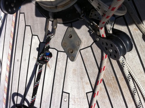

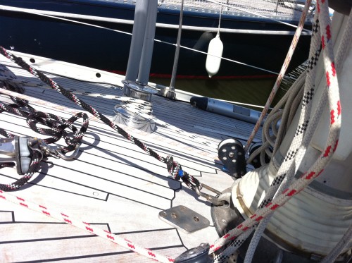

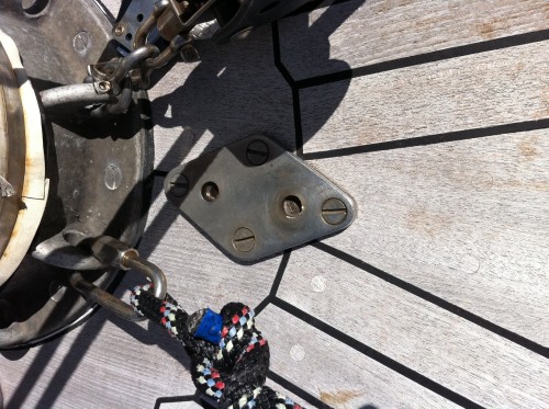

This weekend the D-hook on a steel plate to which the boomvang and reef lines are attached broke of. How do I remove this plate. Do I just turn the bolts from the outside or should I remove the interior roof lining? If I need to remove the headlining how should I do this? Is there a spare part or should I ask someone to weld a new D on the plate?

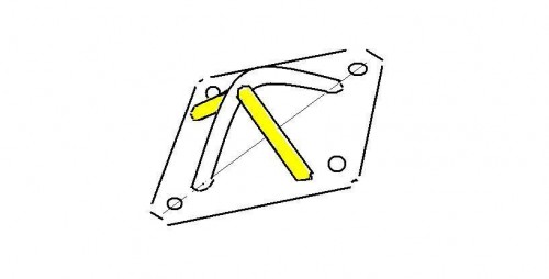

If you have the piece that broke off it could be welded back, or a new piece can be used, but I would suggest a modification. The vang loads are largest when the boom is out, and this loads the D sideways which is not a strong direction. Adding side supports would improve the strength considerably, see appended sketch. The supports should be straight and have the same diameter as the D, and meet it near the highest point. Mount the fitting so the supports are located towards the mast.

I tried to remove the overhead panel. After removing the two teak battens I encounter on both sides a multiplex panel on which the panel seems to be glued. The multiplex panel seems a lot bigger. I am not sure if this is original. How much of the battens should I remove. I was hoping removing the central panel just in front of the hatch in the cabin would be enough. I am afraid that i will have to remove the entire roof.
