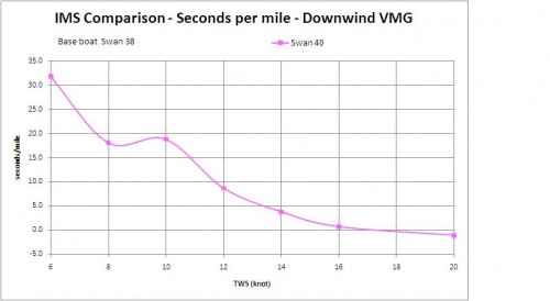

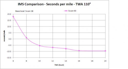

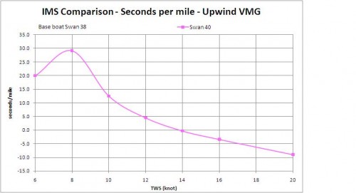

At last the comparison between the tall rig Swan 38 and Swan 40.
According to IMS the GPH (General Purpose Handicap) for the 38 is 3.5 seconds lower, that means she can generally be expected to be that much faster. The GPH does not, however, indicate the strong and weak points for each model, for this additional evaluations are needed.
The differences on specific courses can be calculated accurately based on the certificate information. Here 3 examples - on the wind, off the wind, and reaching at 110 deg true, all over one mile. The base boat is at zero level on the diagram, and when the other boat is above zero she uses more time.
Questions?

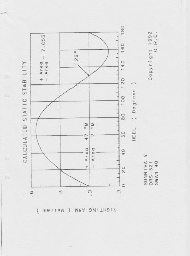

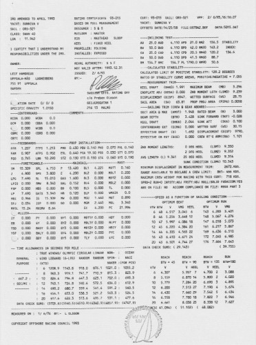

During winter months it would be nice to do some research. As the owner of Swan 40, Becca, I am very interested in a polar diagram and IMS certificate. Read that you Leif have some. Would be really nice!
all the good from a rainy Netherlands
Please find as attachment IMS certificate issued 1993 and polar diagram for my S&S Swan 40  Sunniva V

O Leif,
Have a bit of a problem with resolution of the diagram. Cannot read the numbers of the second diagram very well. Do hav a bit higher res?
