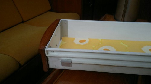

Some of our plastic drawers in the pantry, and at the navigation, are in bad shape. Can new ones still be obtained somewhere? Yves Le Cornec from Nautor Villefranche told me he ordered the last ones 2 years ago, it seems that Nautor does not produce them anymore.

I have the same problem. The drawers are almost impossible to clean and are "yellowing", which looks scruffy. If anyone has a solution to get them white again, or suggestions for replacement, I would be gratefull.

I had a problem that the drawers didn´t keep on their places when the boat heels. The reason was the slide ends which had worn round. I cut a piece of them and replaced with aluminium profile in order to get the ends sharp again. The drawers were also painted inside with normal spray paint. Works suberb, but wooden drawers would be more sophisticated solution.

I'm planning on building wooden drawers to replace the 10 placstic drawers on our Swan 48, Galatea. I'm planning on using rift-cut white oak for the sides and possibly pine, iroko, or sapele for the bottoms. Pine is very stable with changes in humidity, but I don't think it's very druable.
Do you have photos or drawings of drawers to fit the wooden rails or guides inside of the cabinets of our Swans? (I've attached a photo of the wooden rails. Sorry for the imperial units of inches.)

Thank you for your offer, but I have one of the plastic drawers in my wood shop, so I can make measurements from that drawer. I was hoping to get ideas of how to construct new drawers from wood.
In particular, I am not sure whether to make the drawer sides relatively thick (~20 mm) and cut dadoes (grooves) in the sides to accommodate the runners (rails) in the cabinets, or if I should make the drawer sides realtively thin (~10 mm) and attach runners (rails) to the drawer sides.
