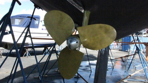

Hi Folks,
Some times ago, I promised to report on my antifouling for propeller. Well, please see the results in the attached pic. After one and half year in the water, there were no growing things at all! Amazing. So, two alternatives: Either the waters in the South of Sweden, where Farouche is located do not support any life OR, the product is actually good!
In the pic, I have just changed the zinc whilst the propeller looked fine from the start. The "magic product is the Kiwi PROPSPEED. It is applied in two acts: a primer and then a clear coat.

01 September 2011 - 15:40
Phillipe, that looks great - I must get some. After just three months in the water Black Tie has small sized barnacles all over the prop and shaft. Thanks for doing the research. Gavin

We have been in a high growth environment for years, and North Island NZ qualifies, migrating between NZ and Fiji, Tonga etc. and have observed extensive Speed Prop results at the boatyard here in Gulf Harour, (all the Kiwi's use it) and it works very well here, provided you renew it every year, and it is not inexpensive.
Since we did Coppercoat bottom paint, and haul only every 4-5 years, when the speed prop has lost effectiveness, and we are back to scrubby pads and 600 wet paper, a effective alternative to a spotless variprop is to place a heavy duty trash bag over the propeller with a cable tie. If this is filled with fresh water from a hose before closing the cable tie, all the growth is on the outside of the bag, and the prop and zinc are in perfect condition when removed.

I have been using propspeed on my boat for a few years and the most I've been able to get is about 20 months, which is great. The product is expensive but if you approach a yard while they are applying it to a set of big props from a mega-yacht, they will do yours for a few bucks. Once you open the propspeed kit you have to use the while thing and it is too much for out little props.
