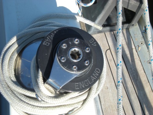

1. Wear on the "waveform" that grips the line in the self tailing mechanism (upper and lower crown) The anodizing wears thru, the grip becomes sharp and destroys the line, or no longer satisfactorily grips. Building up again by welding, grinding back to original shape and then re-anodizing usually distorts the fit to the drum, and costs as much or more than replacements. The estimate given was 160 pounds for replacement top and bottom crowns.
2. Wear/corrosion of the crown at the SS fasteners to the drum.
3. Corrosion at the lower crown to the drum.
4. The plastic bits perish from UV, so we always keep ours with covers, and our covers are made with a waterproof inner top. This keeps water from washing the grease out on the new teak deck and in the winch, and in places like Oz, keeps the blowing sand out of all the parts while not using them.
5. Corrosion at the SS inserts of the Aluminum bases eventually weakens the base enough to need replacement. Tefgel or similar products applied each time you service the winch helps slow this down. I place an oil absorbent pad cut to shape inside each winch when I service them to catch the oil from the base drains so it does not stain the FG or the teak.
6. Wear on gears and pawl pockets should be checked.
That said, these are wonderful winches, robust, and at 30 years old, having sailed 100,000+ miles without a failure, I am very happy to service and change parts as needed, rather than buy new as the holes for mounting are always different, and the new winches do not seem to be better...

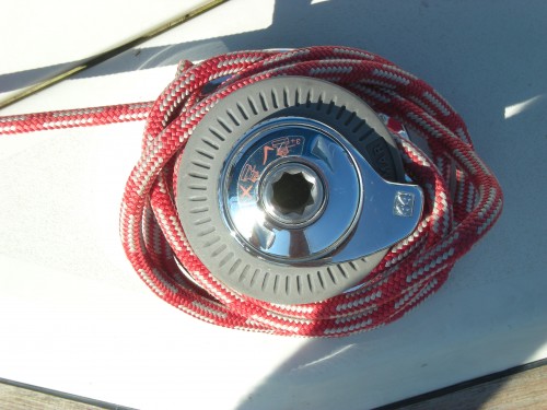

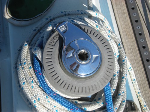

I have (2) each 58ST, 48ST, 44ST, and one each 40ST and 34ST. I think I would need the upper and lower crown pieces for the 58's and the 44's, which are gray and seem to me to be somewhat more vulnerable to cracking then the others, on which those parts are black and appear more solid/less degraded at least visually. As for other parts, I am open to suggestion - everything is working, but I would want to buy any parts that might be 'hard to get' later - so how do I add my parts to the pool?
