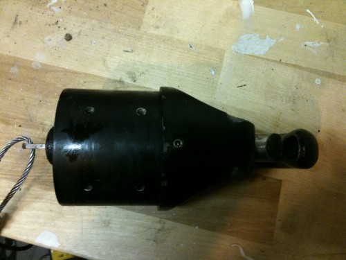

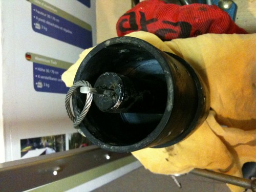

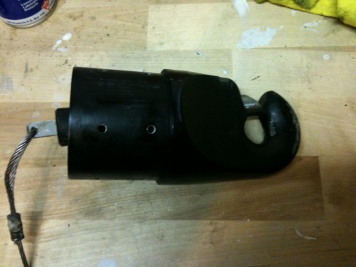

The end of the jockey pole is not moving anymore. I removed the
endpiece And tried to get it moving again with a lot of oil without
succes. Is there a way of dismantling it any further? There is a
central part which is i think containing a spring. Can this be
removed/unscrewed? Is the aluminim part massive?

I would suggest the screw in the center of photo 2 is a set screw for the central sleeve. There may be more than one screw in the same hole. If the pin does not turn you can probably not unscrew the sleeve because this would twist the flat extension with the wire link. If CRC and equal do not help, heating the body and cooling the pin could be tried.
