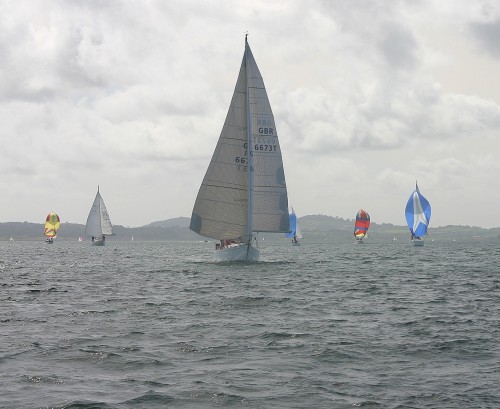

Rob, I disagree with suggestions in the replied posts that dacron sails are better with regard to longevity.
My boat came equipped with a set of UK Halsey Tape Drive roller furling No1. and main which has full length battens on batt cars and also a set of dacron Norths made a couple of years previous to the UK's. The UK Halseys were made in '05 and are still in as-new condition. The reason, double sided taffeta. They are superb sails, and to my mind the quality of finish is far superior than anything else on the market today. They come with some very innovative little touches like the main's leech line adjustable from just above the clew-it's led via a pulley on the headboard back down the luff.
The No.1 also has a double foam tapes in it's luff and sets superbly rolled up to a No.3 in 25-30 knots. I did try out the Norths to see what they were like, they are now back in their bags in the garage at home. I had to do a lot of fiddling with halyard tension before getting the correct drafts on both the No1 & main. The UK's require very little adjustment to set good shapes and there is zero stretch.
I do agree with some comments in the replied posts, laminates can self-destruct very quickly, particularly without the protective taffeta and if you allow them to flog unnecessarily. When not in use they also have to be protected from UV light by a sail cover on the main and a good UV strip or genoa sock on the No.1. I use a genoa sock.
Before making a decision I suggest you have a chat with Butch Ulmer of UK Halsey. I'm so pleased with my UK's I'm going back to them for a Jib Top for distance racing and an 0.75oz Matrix spinnaker.
Since buying my boat last April I've put about 1800 miles on them right across the wind range and there is no wear or tear on them whatsoever. Once a month, and on a quiet evening, I bring the boat onto our club's pontoon and go up the rig to inspect them taking a hose up with me to wash the salt off. That's all they require, and to protect the longevity of sails, either dacron or laminate I think it's a good idea to wash away the inevitable salt build up regularly.
If you like I can take and email you a few photos of them for you to see the detail of finish and their condition after 6 years of use.

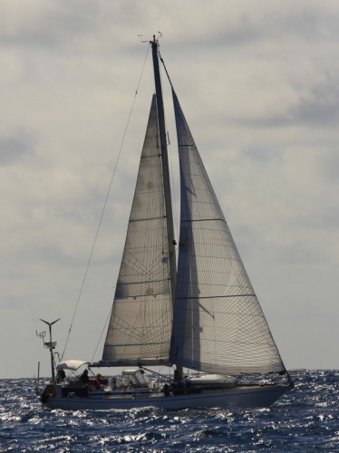

Hi Rob, This is a re-post that we did in 14 January, 2011 titled Dacron vs Laminates: Here on Proximity, we are using a set of UK Halsey Passage Maker II laminates. They are mylar, spectra, carbon tape cruising sails. We had them about four years on San Francisco Bay, then in September, 2009, we went cruising with them. We did Mexico then across the Pacific, and we are now in New Zealand. We had the sails inspected by the local Doyle loft. They are still in fine shape with many seasons ahead of them. Will they last as long as dacron? I doubt it, but they have already lasted as long as dacron would have kept their shape. They are also much lighter than our old dacrons, so there is less weight aloft. So, there you have the two schools of thought. The dacrons will last maybe 20 years, but loose their shape, and are heavy. A good laminate will have near perfect shape until its life is over, and I guess that is the unknown, but I'm sure it will not be 20 years. Bottom line is that we too, are happy, and would make the same decision again. Either way, you'll be happy. New sails are wonderful!! By the way, if you would like to see more of these sails, we have a website of our travels with many photos. It is www.sailproximity.com Best Always, Rod and Elisabeth
So, Rob, there are some really good modern sails out there. I don't think North's Norlam is so robust, and I don't know about the others. But I can say that after well more than 8000 cruising miles, we are really happy, and are continuing the push westward....but then again, another season in Fiji sounds good too. Best Always!
