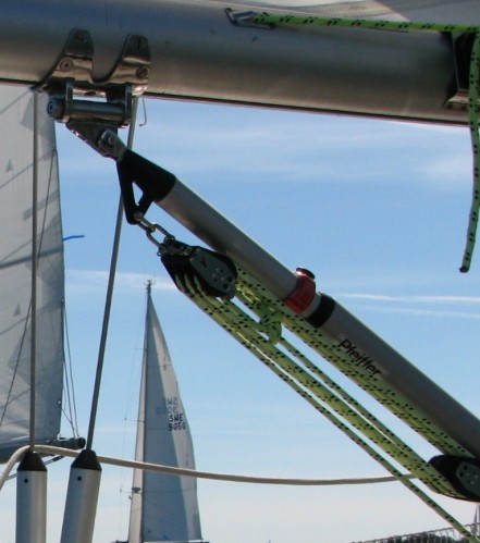

Hello, Philippe!
On our Infant, we have a boom vang made by Pfeiffer.
Jyrki 38/014
