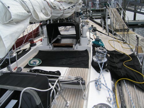

Swan47 CB -1984 #68, Cygnus. We keep Cygnus in the Caribbean, and though family and friends visit often, my wife and I are the crew. We are both in our late 70’s and we are considering replacing the Lewmar (55 ST) winches at the forward end of the cockpit, P&S, and installing Electric Lewmar winches (55 EVO ST) in their place. Our concern is do we have room under the cockpit coaming at that position to accommodate the motor and gearbox which is offset from the centerline of the winch by about an inch to one side, and about 8 inches in one direction fore and aft, and about 2 inches in the opposite direction. We won’t be able to get to the boat until mid-January for measurement.
Has any member done any electric conversion? What advice would you offer? Mel Boudrot
