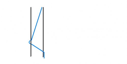

It is assumed the noisy halyard is coming down close to one side of the mast. Fish out a small bight of it through an exit on the opposite side, put a horizontal pin through the bight, and tension the halyard into a diagonal position, see sketch.
Does it work in your case?

This could work but I hate cutting holes in masts! How are the existing halyards threaded inside the mast at the moment. I have no noise now just concerned about the new main halyard.

You could also push the noisy halyard towards the opposite side with a stick through an exit on the same side.
Provided you can tell me in which order fore and aft the halyards exit each side, and whether they exit on the same side at the mast head I can tell you how they should lead inside the mast.
There is the possibility that halyards are twisted around each other, this causes additional chafing, and should better be rectified. They can also chafe on the tang bolts which go through the mast.
