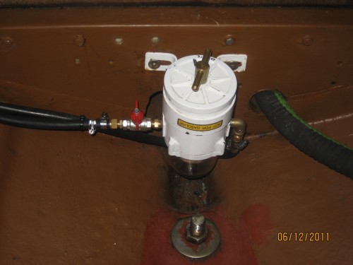

For your information where the pipes run through the bulkheads they are fixed with a mastic, presumably to stop water ingress and damage due to rubbing. After 34 years I found that where the pipes had been in contact with the mastic the pipe colour was very orange indicationg greater levels of corrosion. So it might be worth a look at yours if not already replaced. I have also fitted a stop cock directly onto the racor filter as I found when changing filters diesel always split into the bildge. This is the residue fuel which remains in the pipe after you close the value at the tank.

Picture shows the new fuel pipes fitted, we had to use a smaller gauge pipe on the return side of the system to get both pipes through exsiting holes. Also the new tap fitted to the Racor primary fuel  filter and seperator. We can now change filters without diesel getting into the bilges.
