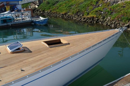

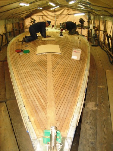

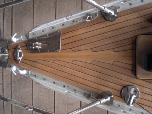

upon several years with ad hoc repairs on original deck from 1979, finally decided to have it all replaced. Checked with four suppliers for such job and ended up with Finnish teakdeck specialist through Nautor Spareparts. Result was an immaculate new deck, now attached to boat with vacuumpressured epoxy system so no srews and plugs. Cost? this job certainly expensive but relatively fair. Deck was produced in Ostrobothnia and forwarded on truck to Norway (2000 km) in six large peaces plus cockpit peaces, about 200 kilos total. A container of tools and equipment followed on same truck. Two well dedicated craftsmen arrived at same time and everything seemed extremely well planned, completing job at their estimated time. (no surprise) As an example on their efficency; all hardware and original deck was removed and deck faired in three days. Total job, 17 days. Boat has really become a Yacht again.

Dear Thorbjorn,
Fantastic!  Beautiful.  I think you will be the envy of everyone who sees your beautiful yacht!  Money is not wasted on these beauties.
Thank you for sharing the pictures.  Please send more!

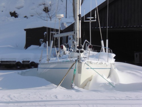

Many thanks comments. There was no oil or other treatment added to deck for finish, just sandpaper-work with not so very fine corning. How deck otherwise was built, would recommend to approach supplier in Finland. Deck-laying procedure seemed quite heavy duty with regards epoxy attachment to hull which duly needed here north with long winters. Snow we have every year, sun(uv)during summer also every year more or less. By all means, deck will have better shelter during off season months in years ahead! Thorbjorn/Ravn 411/36

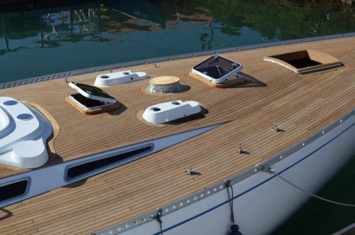

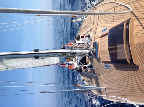

Baron's new deck shown here - cost was around €50,000. Same type of fitting as above - ie no screws . The supplier was Moody Decks and fitted by Berthon. Teak thickness 12mm.
David
Baron 411/33

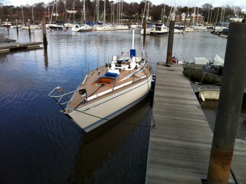

Swan 411/33 Baron

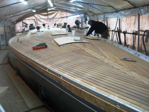

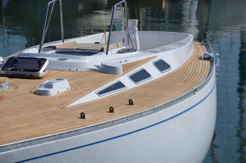

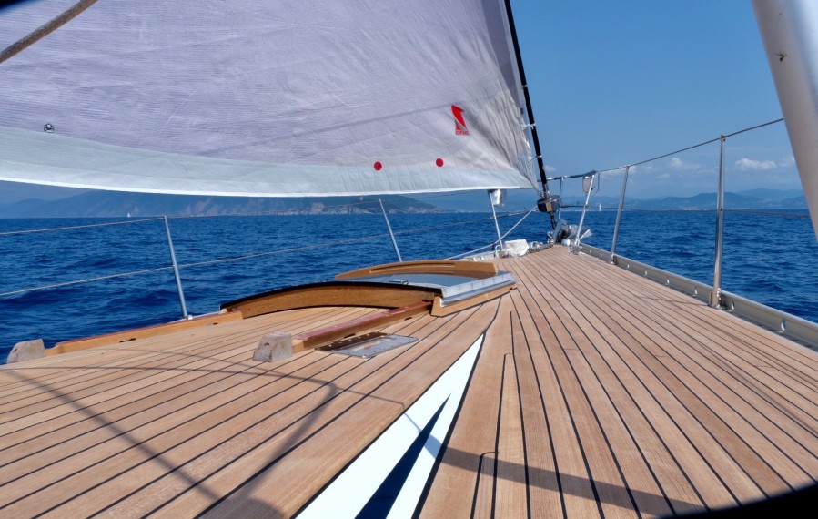

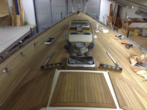

Pippus new teak deck this year was fitted as above no screws, piece by piece, thickness 16mm, new sliding and central hatches, new prisms, around 5 months of works at well experienced Caffarena shipyard in Carasco Genoa.
Alberto

Dear Alberto
Decks look beautiful!
Did Cafferena really spend 5 months on the decks and hatches or was there other work involved?
In my own case that's about what I've spent on mine all told, but it's hard to believe. If Cafferena spent about the same amount of time I'll feel much better!

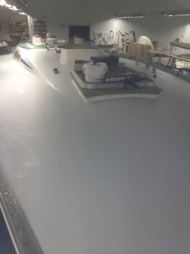

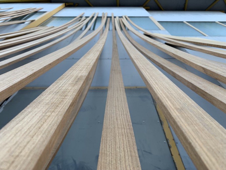

The pics were send before the text: Yes, the Swedes are also excellent in matters of the teak deck. Let me mention the fact that they did quite an elaborated job on the deck before applying the teak: epoxying and gel coating it all into a new state. Then, the teak went on, Vacuum glued of course,
Cheers//Philippe

Dear Tonyh,
5 months of work was needed also to find a new the mast with an original oval profile, painting, rigging and equipment, winches overhaul etc.
Probably the teak deck job last 10 weeks.

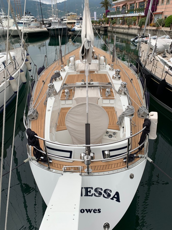

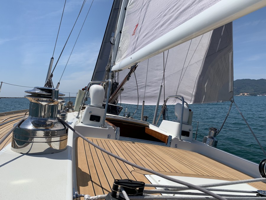

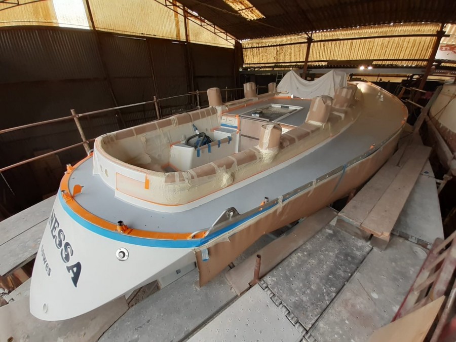

I have Vanessa's deck replaced last year, 12 mm of "Rigatino" Burma teack, planks 4,5 to 7,30 m long, and a caulking of 8 mm of depth. I am happy with it. The difference between 10 and 12 mm was not much. The big difference is when you want long planks and first quality "rigatino".
Attached some pics of final job
mattepo (47/069 Vanessa)

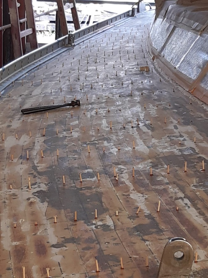

I think so, 4 mm not enough; standard is 6, I asked 8 to the shipyard where my declk has been redone. If Kairos still has the original (screwed) teack deck one of the important think is to close every single old screw hole (see attached photo of job done on Vanessa's deck, about 2,000 pins glued on old holes...argh!).
matteo (47/069 Vanesa)

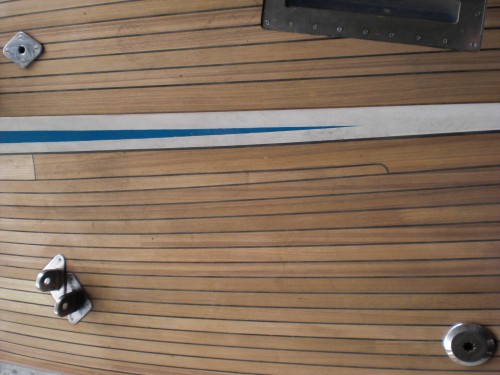

Kairos' current deck appears to be one of the 'prefabricated' types where whole sections of teak were glued to a base (FRP, I believe) first. The section were then glued to the deck and it appears that the bond between deck and base was either not done properly or is nearing the end of its life.
There are some screws in the teak but only on the outside planks - we will ask for them to be properly plugged as per your photos. I can imagine that time spent on preparing the deck base is most important to avoid issues later on.
Had another chat with our boat yard - they said that since they are glueing the teak planks indivially and use 'tradtional' planks and glueing methods i.e. no prefabricated distance pieces or 'click-system' that are part of the teak planks and would therefore decrease the chaulking depth they can achieve an 8 mm chalking depth even for 8mm thick planks.
