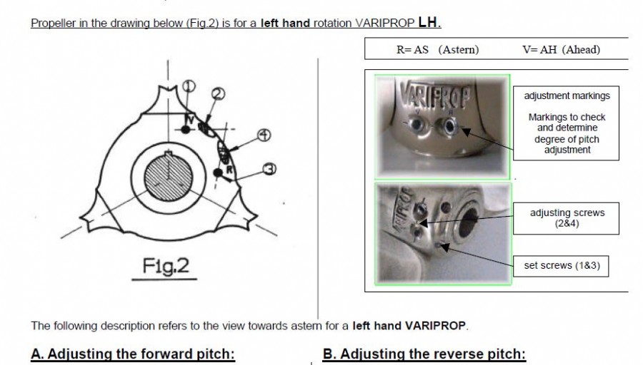

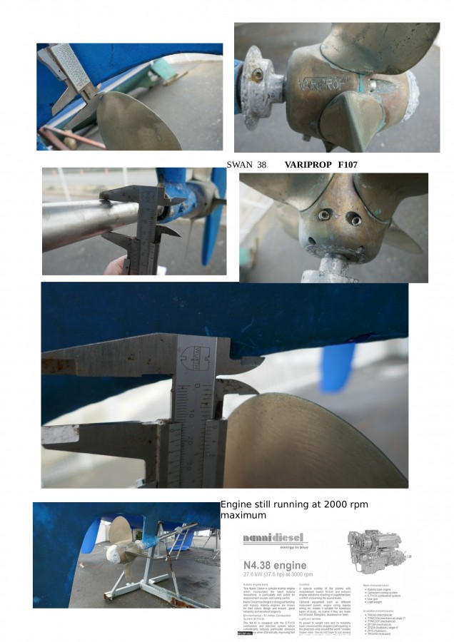

Who can provide me with a short and clear information for a correct adjustment of propeller .
Swan 38
Propeller Variprop F107
Nanni engine N4.38 running at 2000 rmp
All picture attached
Problem : the boat is not manoeuvrable when moving backwards.
Thank you in advance for any explanation.

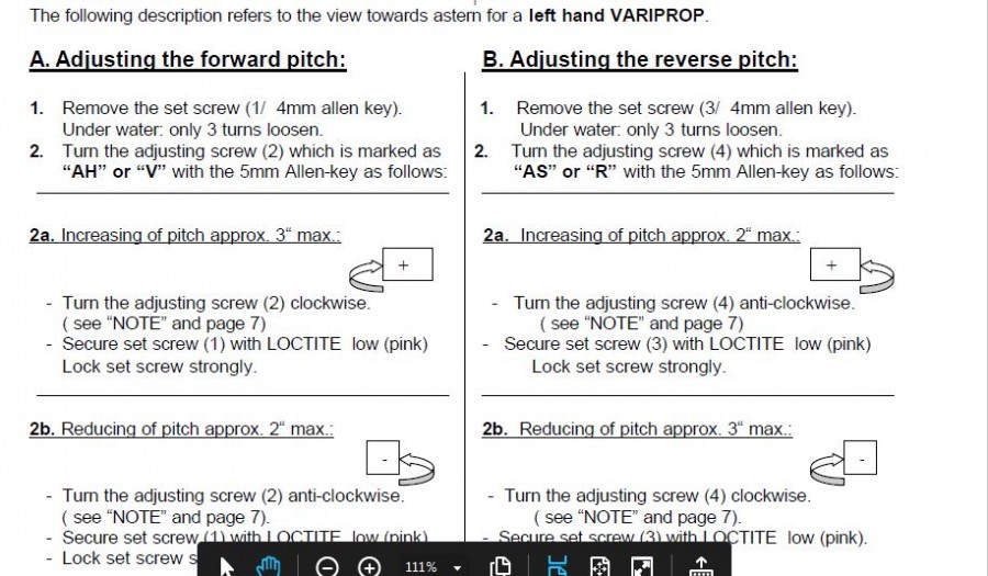

The propeller pitch should be adjusted so the engine can reach its nominal rpm 3000 at full throttle.
Propeller walk in reverse is a feature on all S&S Swans with skeg rudders and V-shaped aft bodies.
Start reversing at low rpms, and let the boat slowly pick up some speed, so the rudder begins to bite. If this is not possible in restricted spaces, then turn the boat on the spot by using fwd/reverse alternatingly, and turn the rudder to the full angle when engaging forward gear.

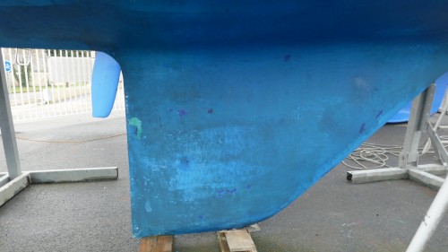

I tend to agree with Daniel, would be good to get used to it. Pls read the thread, there one owner describes how to do this.
If you feel that propeller walk is unacceptable, fins added to the P-bracket for redirecting the propeller slipstream in reverse is one possibility. As far as I know this has not been tried.
Another possibility is to change the engine installation to Saildrive, then the propeller shaft is horizontal, and the reverse slipstream does not hit the V-shaped hull.
