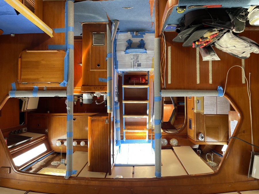

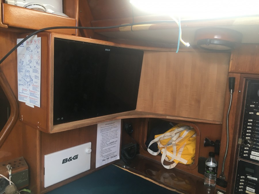

57-007 Refit continuation hello, here the suite of 57-007 Algol V (ex Macobi, ex Flyer) still waiting for outside jobs (paints, teak deck, winches, ...) a lot of work already done inside but not finished... Yves / Algol rebuilding a chart table with a 24" B&G screen not yet finished |

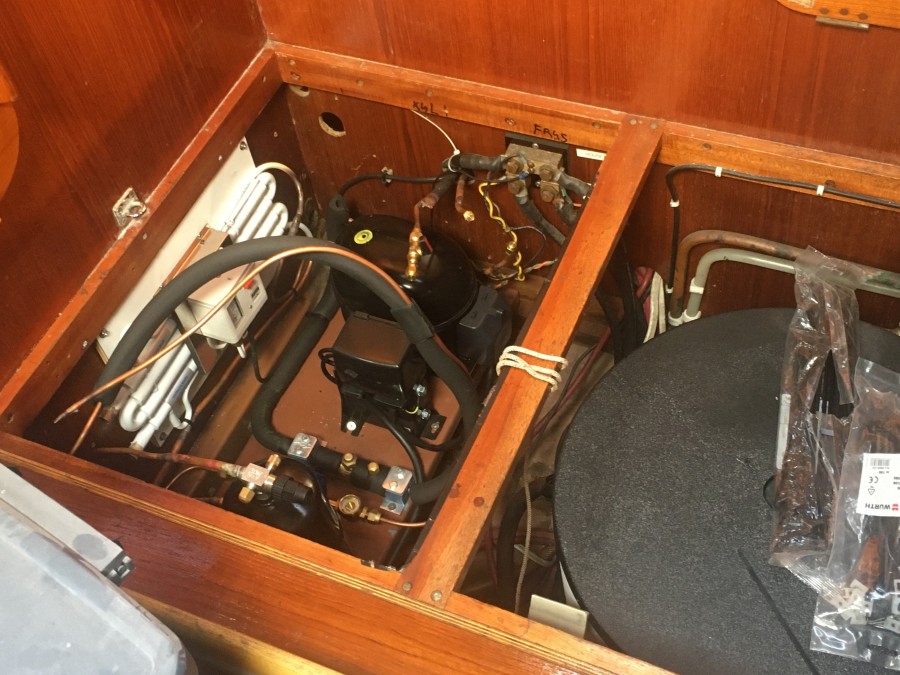

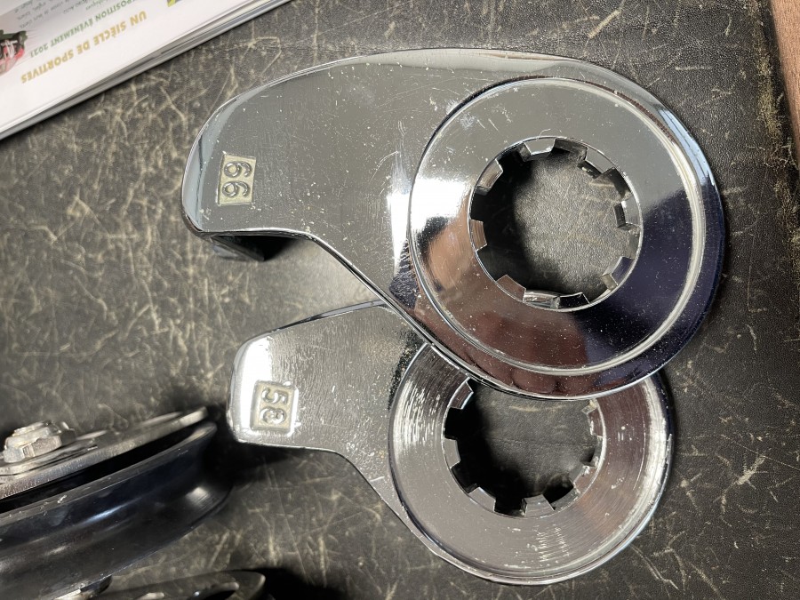

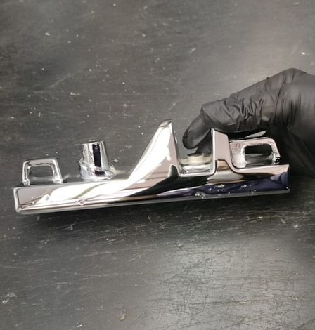

![]() some chrome works... some new fridge freezer group (not finished) some water maker, not in place... |

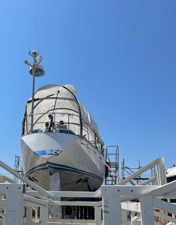

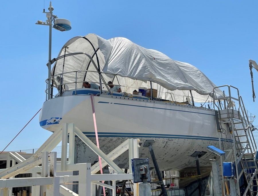

hi ! yesterday at the yard, to see Algol... works in progress... waiting for the new exhausts water maker in place, fits exactly... mast step in place |

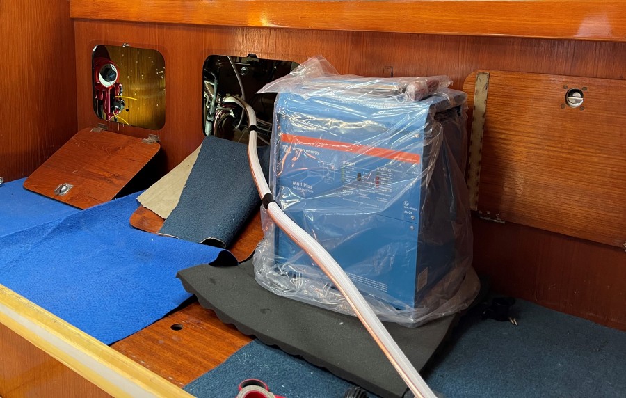

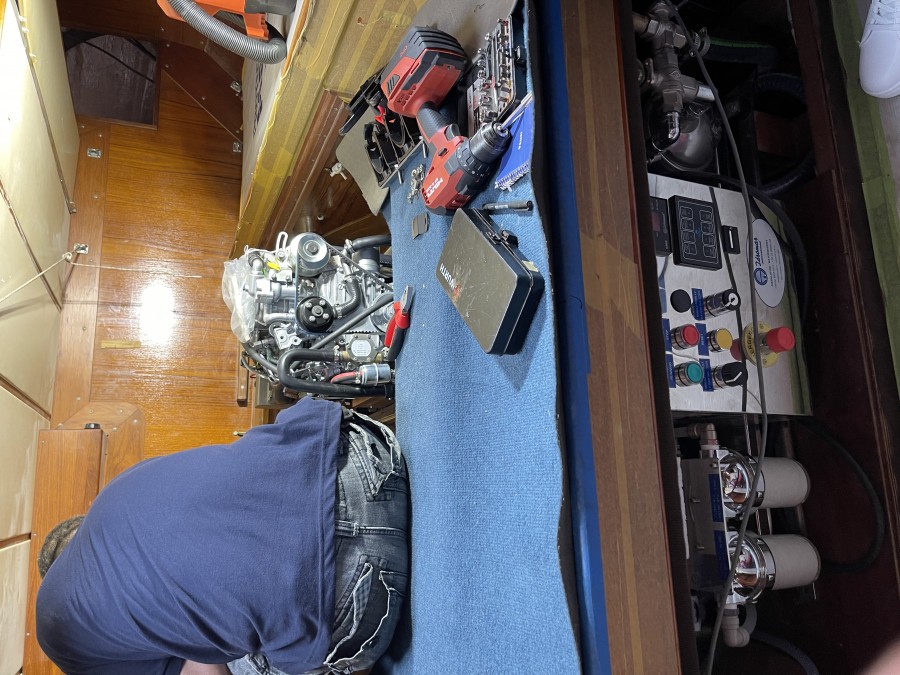

the chaos... the new inverter, waiting for fridges groups finished to go in place... NSGS promotion... |

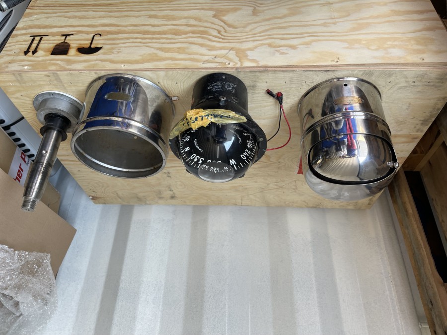

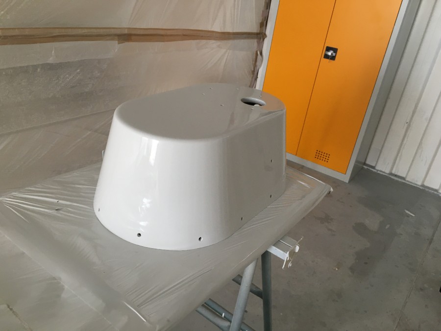

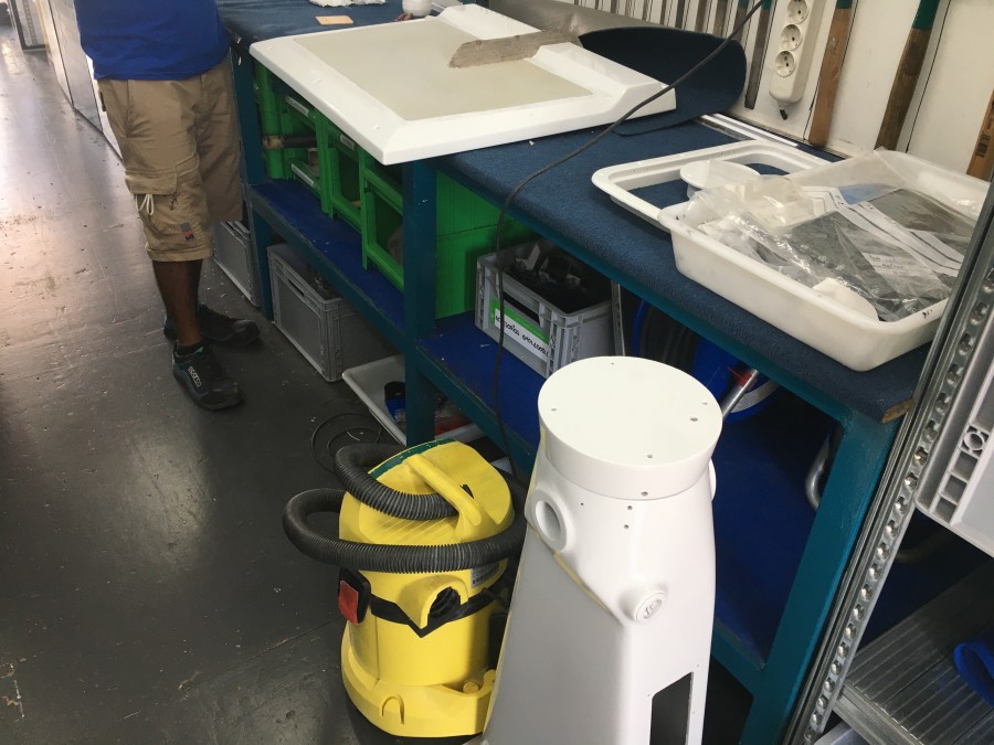

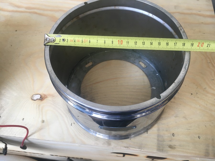

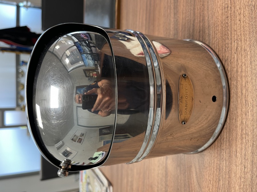

I had a little surprise yesterday, bringing a spare Danforth Constellation 6" bought on ebay, because I missed on my compass the superior dome. Originaly the compass is a 6" that fits on the S&S Swans holder, what I tought I had... but on mine, there is a spécial aluminium plate to fit a 7" !!! so... I can remove this plate and install the 6" instead of the 7", or I still have to fight again to find a 7" dome... was this usual to change the 6" for a 7" ? the spécial aluminium plate seems original Nautor work. well... lets continue to search... Yves / Algol the constellation 6" found on ebay, with his dome the surprise... what I have to find now... |

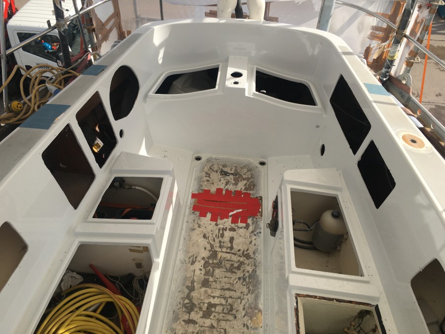

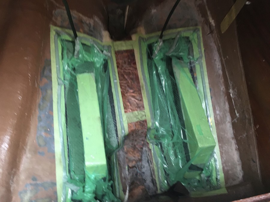

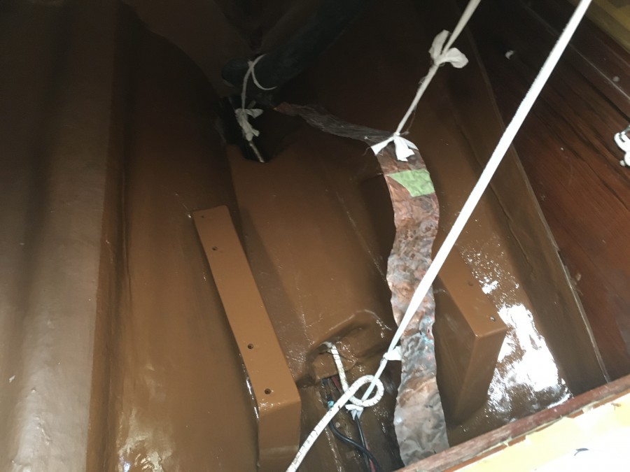

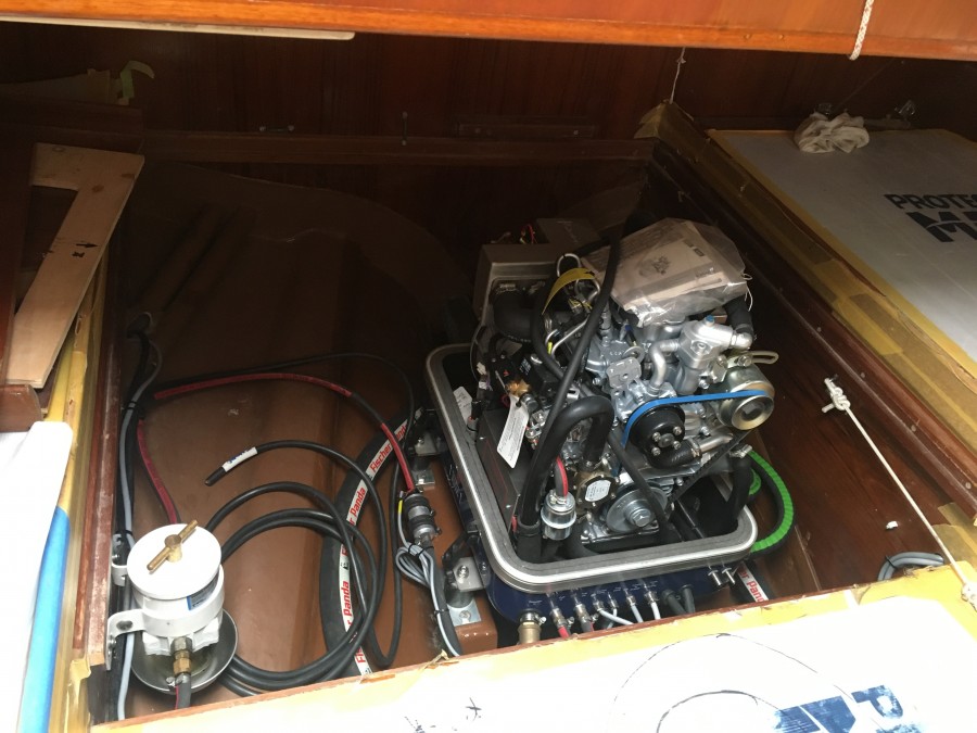

Hi everybody, some update on Algol, while some were "playing" in Marciana Marina… first pictures on Generator Fisher Panda 10 KvA in aft cabin installation ![]() Supports stratification, after removing ballasts ![]() Original repainting ![]() Generator in place |
Join Date: 17 July 2020
Posts: 105 |

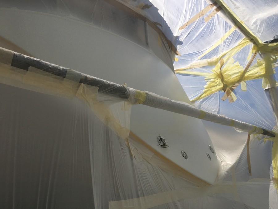

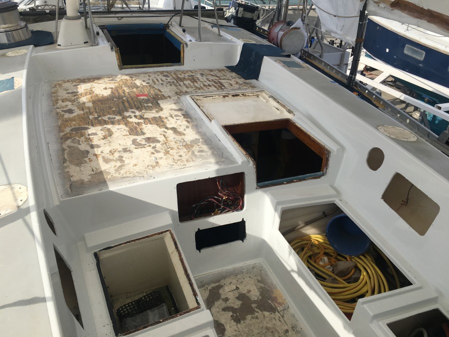

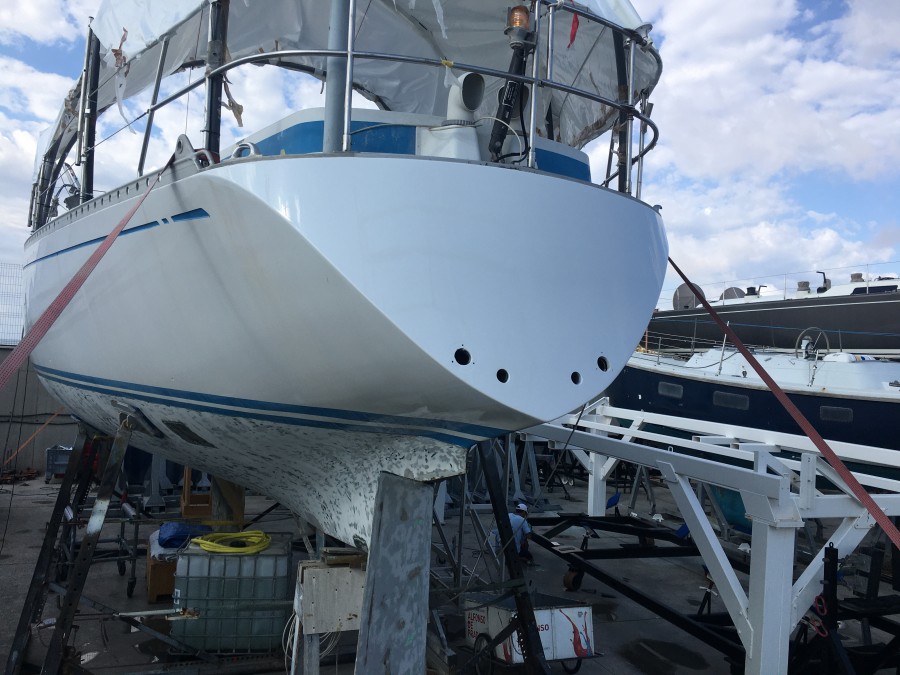

Transom holes modification to fit with new systems inboard, painting in process, and cockpit too, before new teak… ![]() ![]() |

Some details, some reflexions... ![]() Is this still aft cabin or engine room ? ![]() Stainless steel collection… ![]() Chromed brass |
Posts: 105 |
Bronze not brass… sorry… thanks Matteo !!! Yves / Algol |

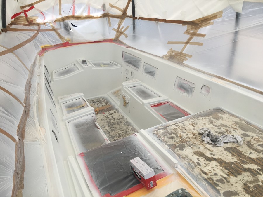

Beware of fresh paint… ![]() ![]() ![]() |

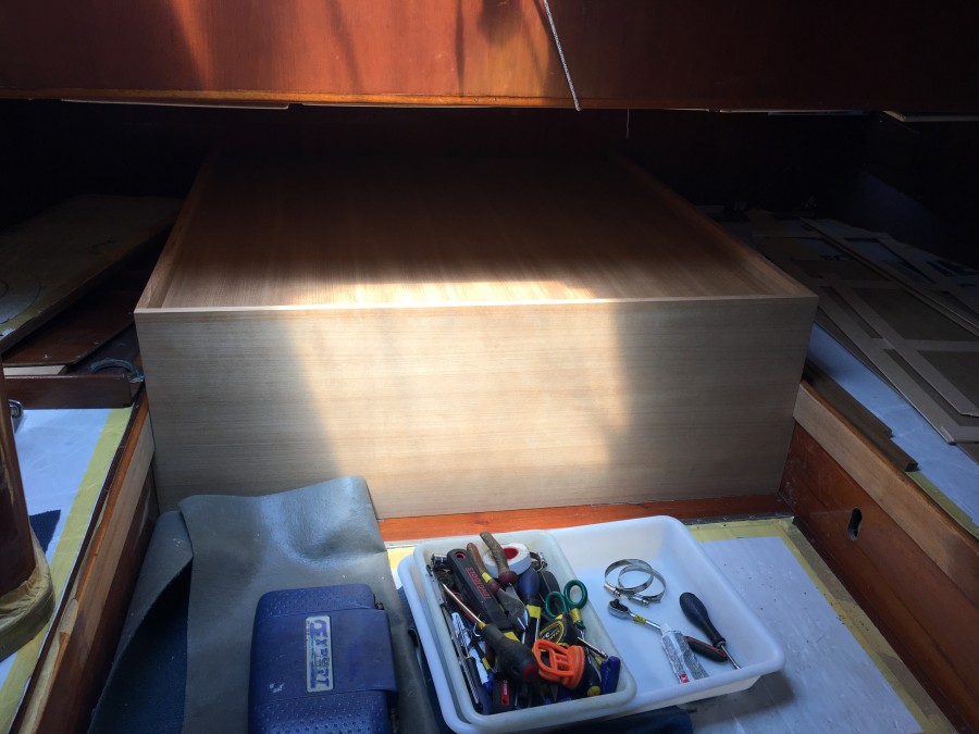

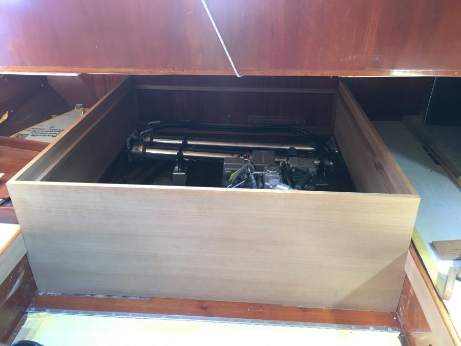

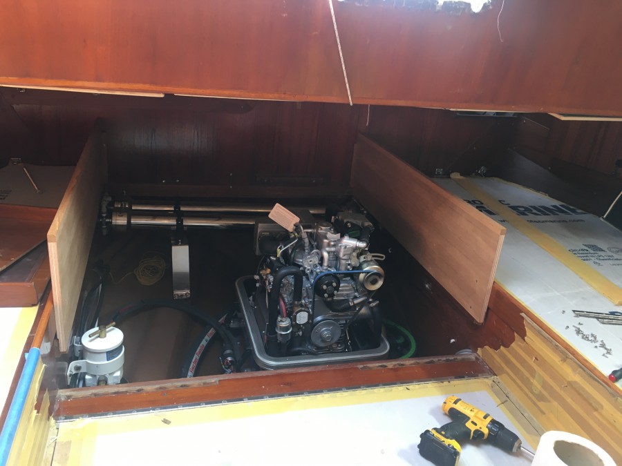

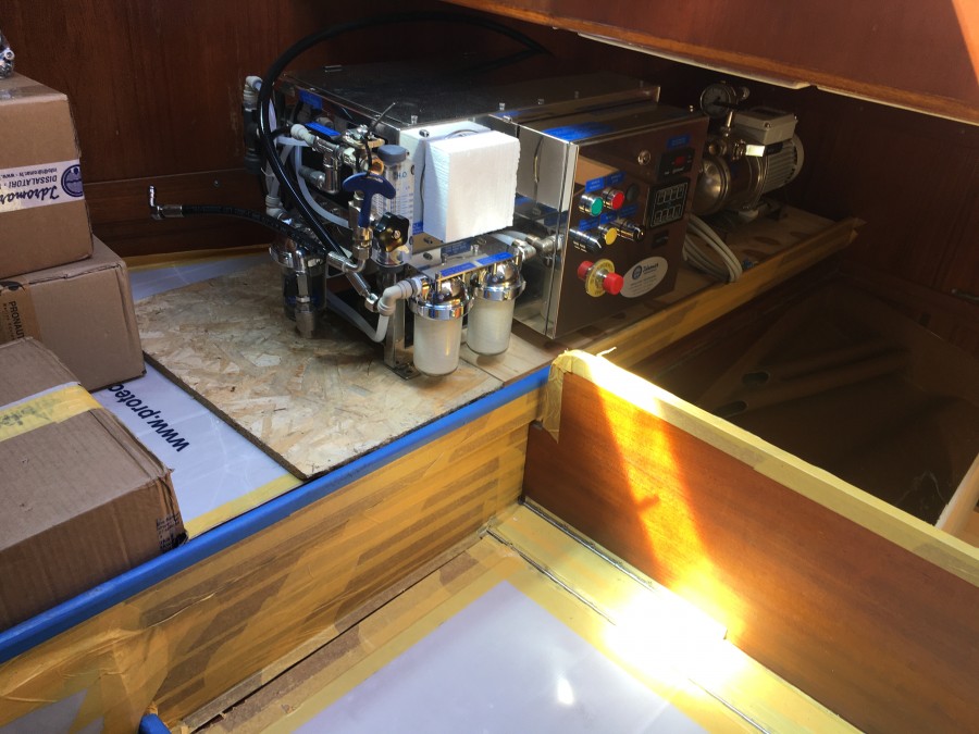

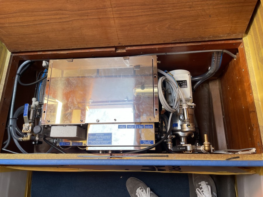

hidding generator and water maker, once in aft cabin... sides front top |
Posts: 105 |

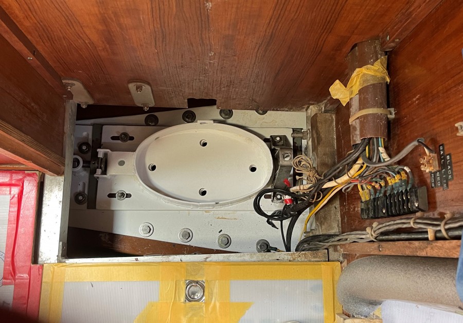

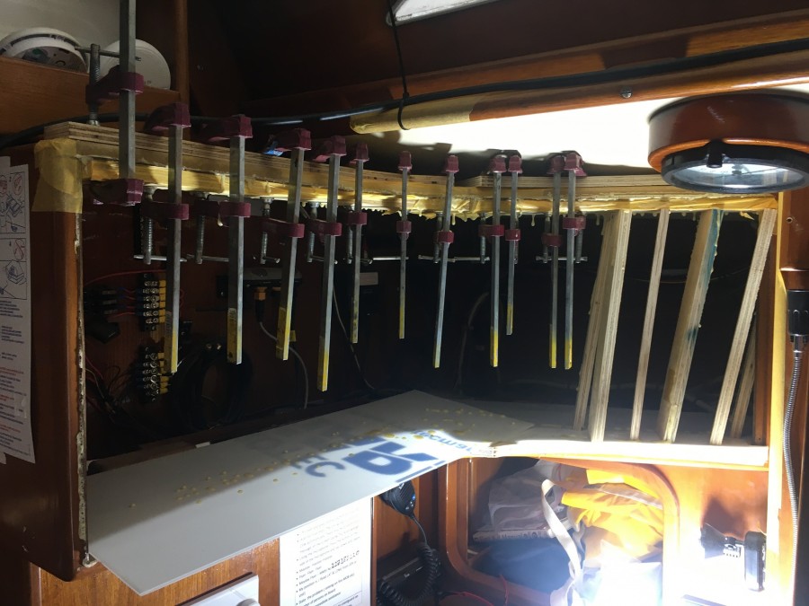

on aft cabin, still missing of course varnish and phonic and thermic insulation inside the box... now some reinstallation outside of refurbished parts, and teak (but no pics yet) working on mast and rigging too, but no images yet too... boxes repainted and modified compass support (with the 7" extension) and hatches cover... aluminium electric winch support behind mast... |

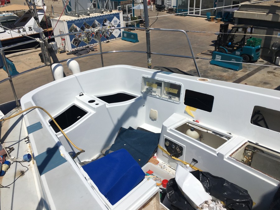

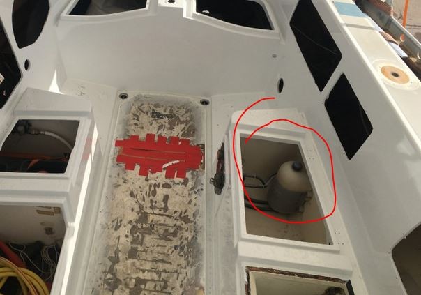

Posts: 148 |
Hi Yves, thanks again for the progess report and the excellent pictures! I noted what looks like an expension vessel in the aft port locker - may I ask what this is for? Have marked it in red in the picture below. Thank you, will create a (hopefully) similar thread on Kairos' refit (much less extensive) when I get some pictures from our yard. Fair winds and hope all going to plan, Stefan Kairos - 57/0043 |
Posts: 105 |

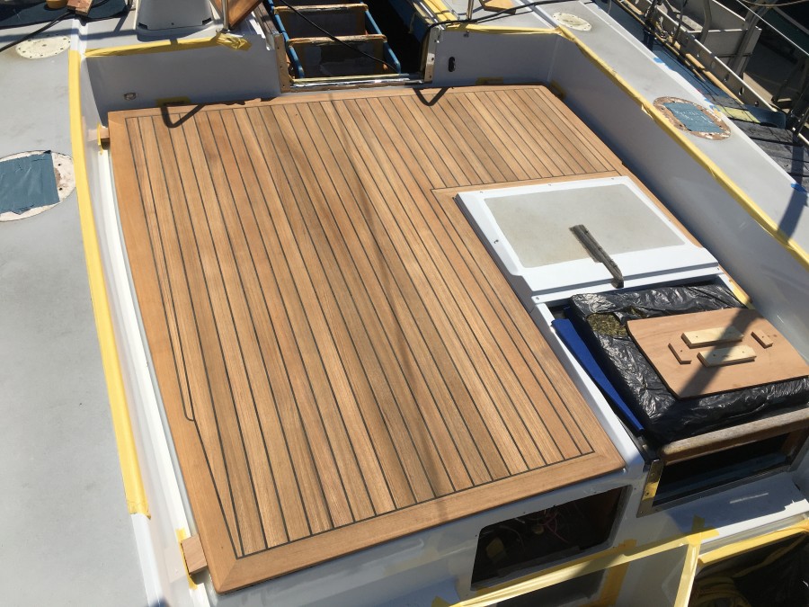

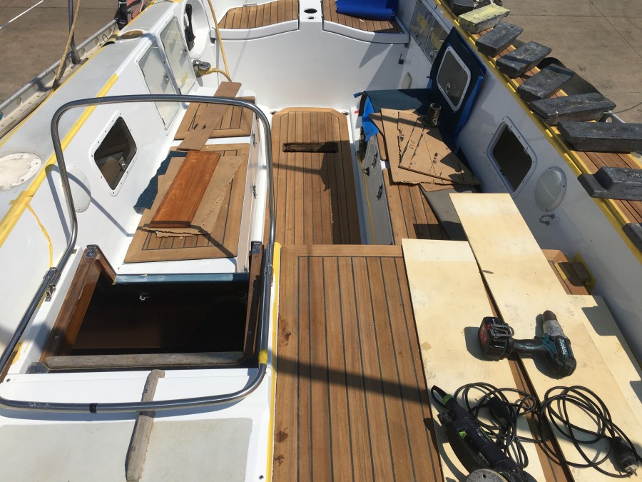

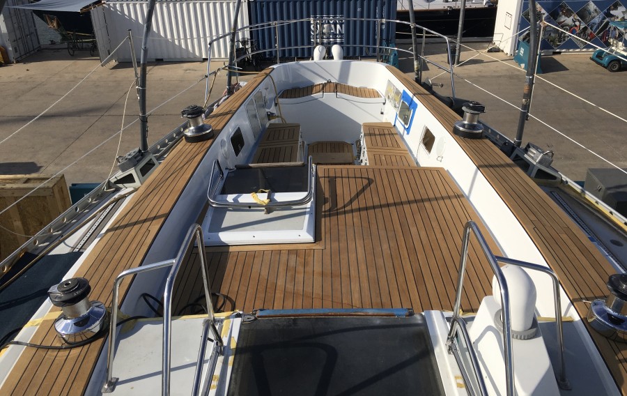

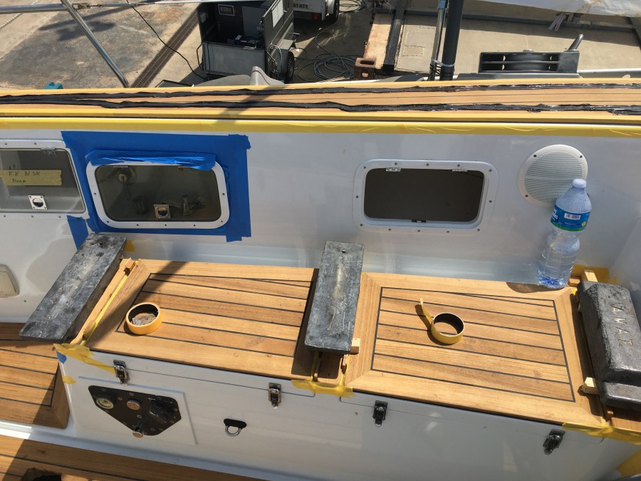

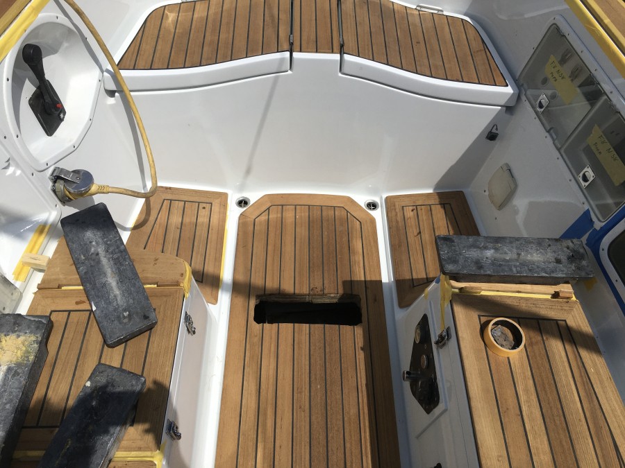

Hello Stephan ! this is the oil reserve for the Navtec hydraulic system (vang and backstay) I found ideas on Kairos pictures, and other 57's I can find on the net, so I share, this maybe will help for another refit of another beautifull S&S Swan 57 ! today some teak progress : the Lewmar 88/3 custom line is waiting to jump on the coaming ! ![]() Fwd cockpit ![]() Aft cockpit ![]() Coaming… dont miss the “little” Lewmar on the right… |
Posts: 105 |
What a pleasure to see teak coming back… ![]() ![]() ![]() |

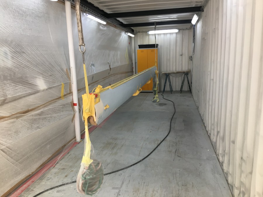

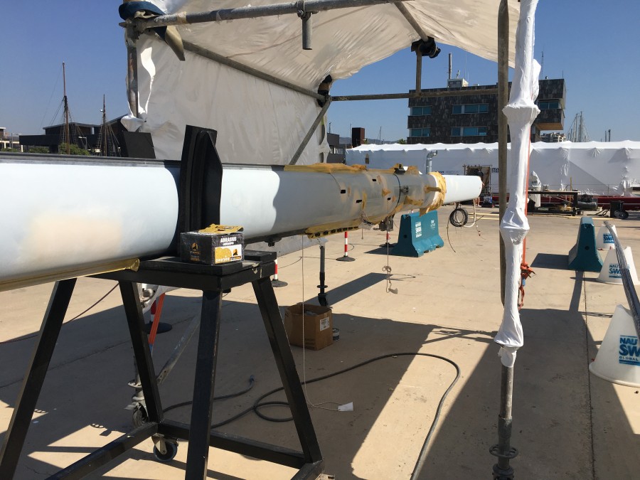

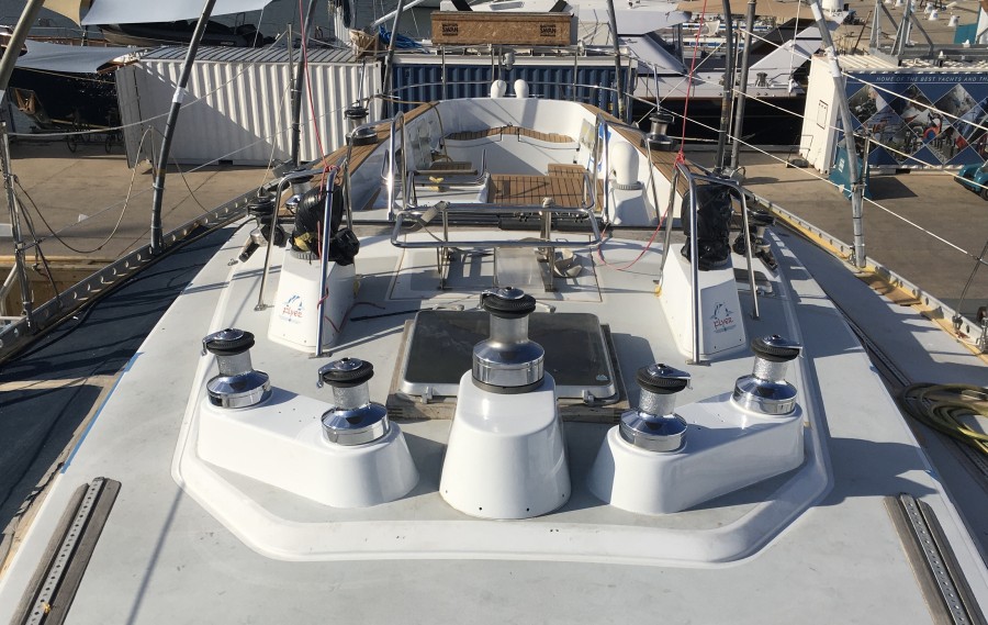

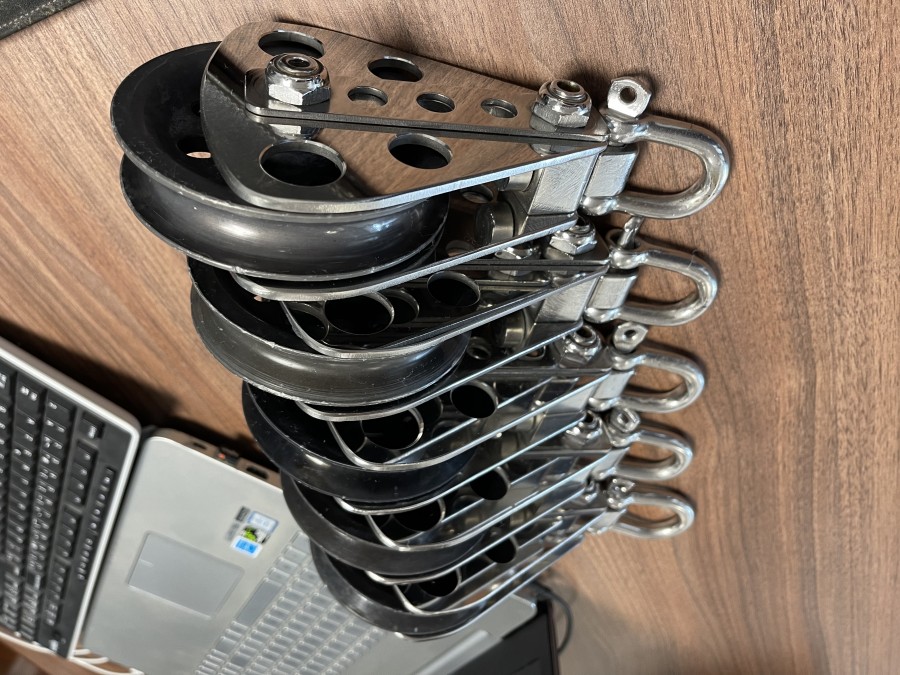

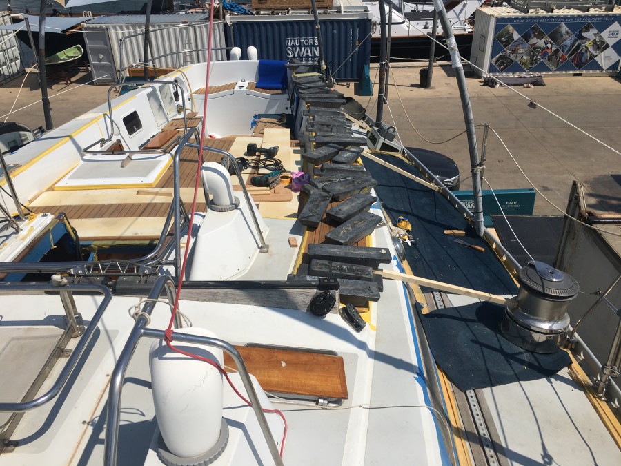

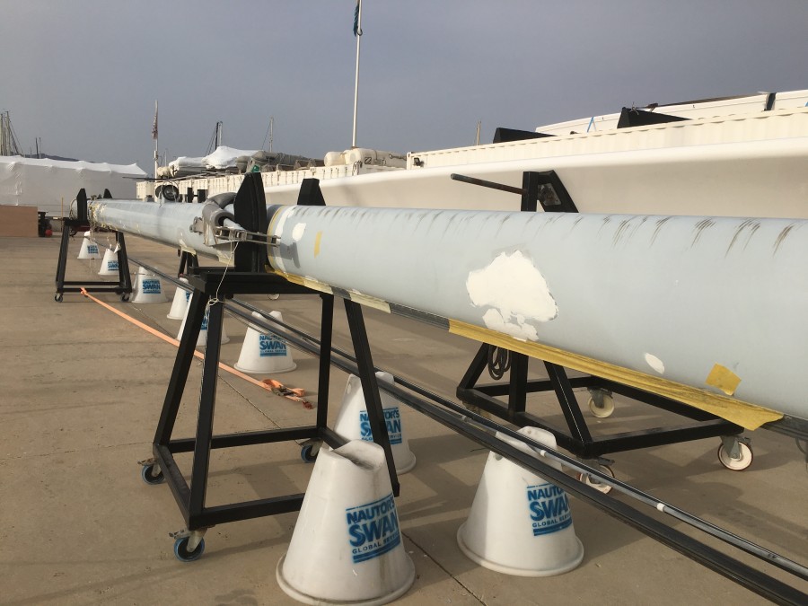

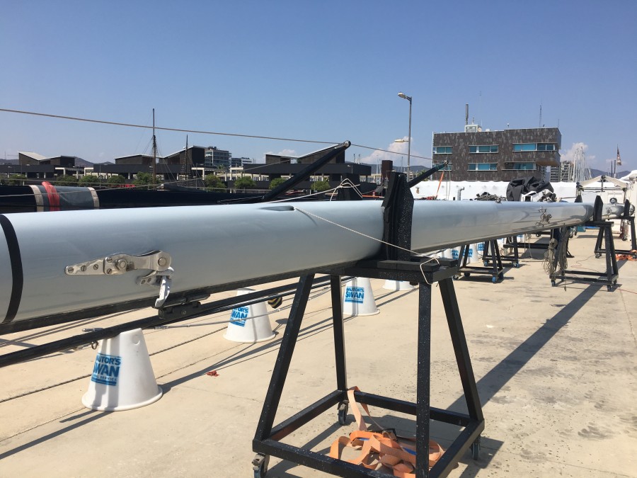

Hi Stephan, hi all, yes I found a lot of ideas on this site and in the forum, so if by sharing I can give ideas to others, that's my contribution … today a bit of mast refit… where, as say Paco from NSGS we have a "funny" situation : 9 intakes from lifts, etc and 8 exits (and 8 blocks at mast foot) we think the staysail hallyard is not original and has been added, using the port side lift exit, but not sure… we search where we will add a 9th exit in fwd part of the mast… but we must escape all the pole system… if someone knows tell me ! have nice holidays and fair winds Yves / Algol V 57 007 ![]() Boom in painting process |
Posts: 105 |
a small resume of the mast process in following pics the complete ROD rigging will be new. step 1 : remove corrosion, passivate, sand and fill step 2 : primer and water light sanding step 3 : paint and look at result... |

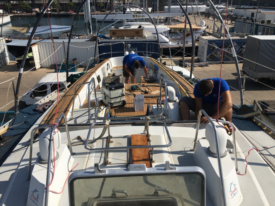

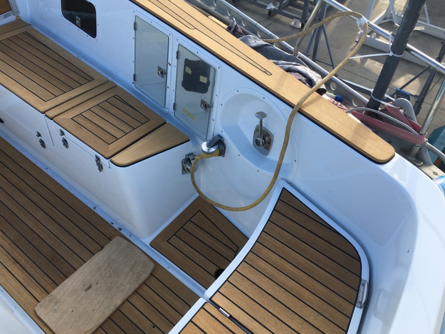

First part of teak finished… waiting now for the main deck… reinstaling coaming aft mast equipment ![]() New cockpit paint and teak covering ![]() New « old style » Lewmar engine command ![]() Mast winches back in place |
