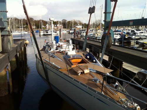

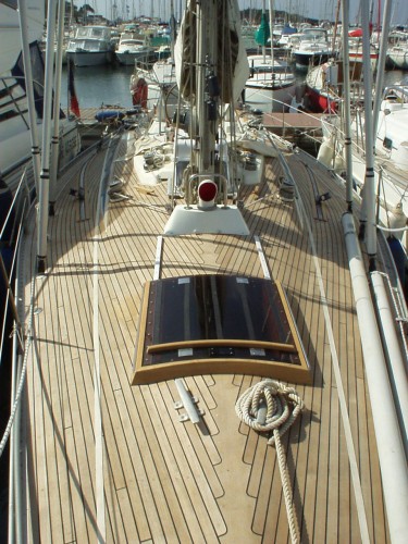

Thanks all for your continuing advice, unfortunately I'm a long way from Scotch Bonnet which is in NZ at the moment but will check the number of catches as soon as I can, in the meantime is there enough detail in this picture for anyone to form an opinion? It seems to me that other hatches pictured have visible external fittings in the corners so perhaps we only have 1 catch. Out of interest speaking to a business friend today, a keen sailor visiting from UK, I showed him a photo of Scotch Bonnet which he correctly identified as a Swan 41 and told me he had sailed on one in the '79 Fastnet race, I've sent him a message to see if he remembers the name.
Andrew

Andrew, there does not seem to be any catch on your hatch.

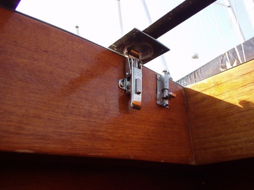

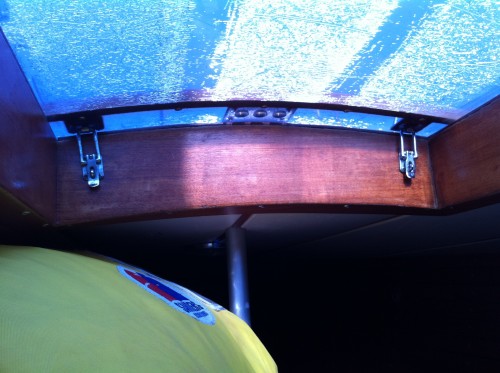

Please find enclosed photos of the modified hatch of 41/022 with four Fasteners by Protex (part nb 61-1610). Adding seals and modifying the rails to have the hatch "dropping down" on the seals as it closes completely solved the problem. I can send you detailed drawings if you wish and sen me your e mail.
Kind regards.
Philippe 41/022 Soeur Anne

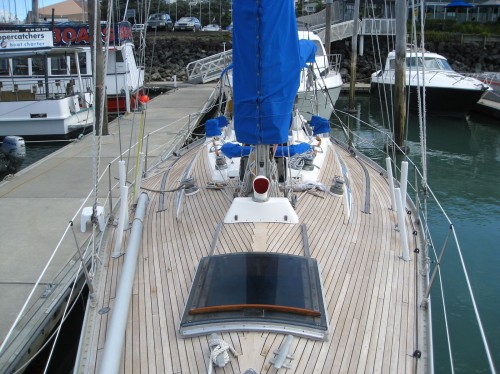

Baron (411/033)emerged from an extensive refit in February 2011. I replaced the teak decks and faced the agonising decision about the front hatch - should I replace or rebuild. Following advise from threads on this site (the really knowledgeable SS Swan owners)I decided to rebuild the original. In preparing for racing this year I have seen the advantages of the S&S hatch when pulling spinnakers into the pit. I will be interested to know which Swan 41/411 completed the Fastnet. Here is a photograph of Baron as she was being launched in February clearly showing her rebuilt hatch.

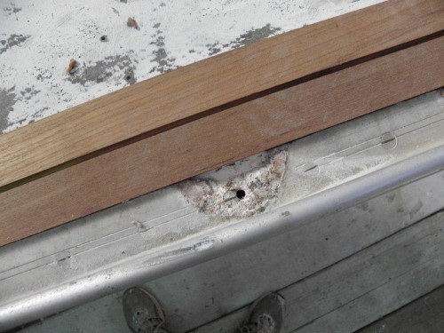

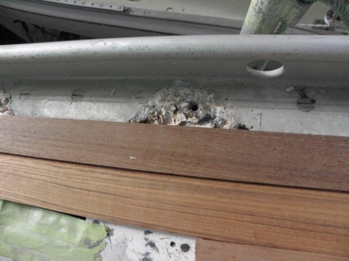

Can I ask for more advice please? Please see pictures attached showing corrosion of toe rail under the feet of the pulpit now removed. The yard's suggestion is to clean up as much as possible and then place a hard wood pad in there to fill the gap with the rail base covering the pad, does anyone have any comments or alternative suggestions?

Would strongly advice against using wood over corroded aluminium, that will cause more corrosion. Clean out, fill recess completely with zinc chromate, put thin pad of hard plastic or GRP under the fitting. Take care to leave a gutter outboard so water does not stand there.
Sophie B is Swan 411-025

I am sorry for the delay. I have four Nautor catches securing my fore hatch. The front two are shown in the photograph below. On the subject of Sophie B; she was in Group 2 of the 1979 Fastnet and retired. She was owned and sailed by B H Owen. She is currently (2011) in the Royal Capetown Yacht Club (RCYC) in South Africa and is owned by Mr Musgrave.
